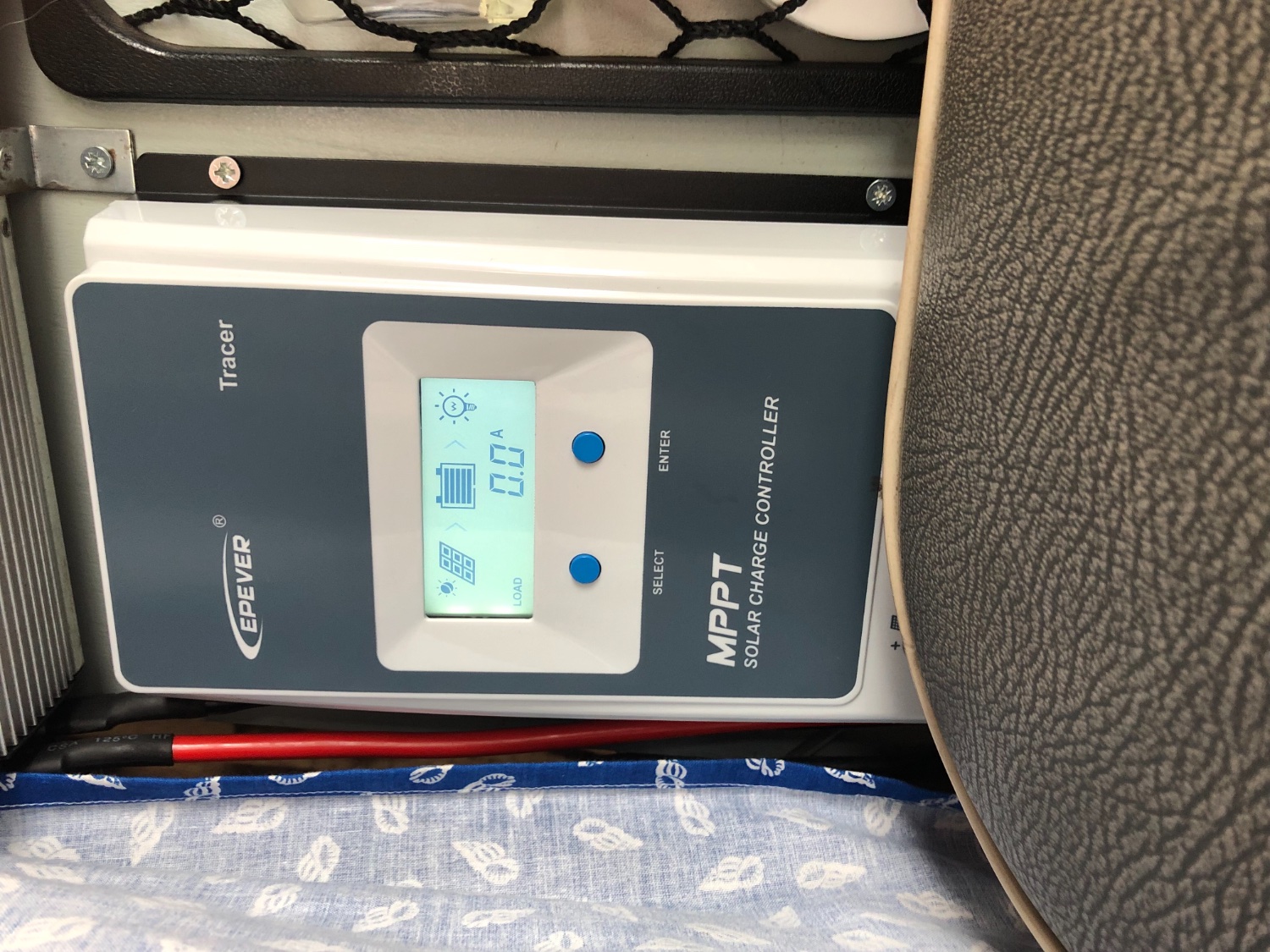

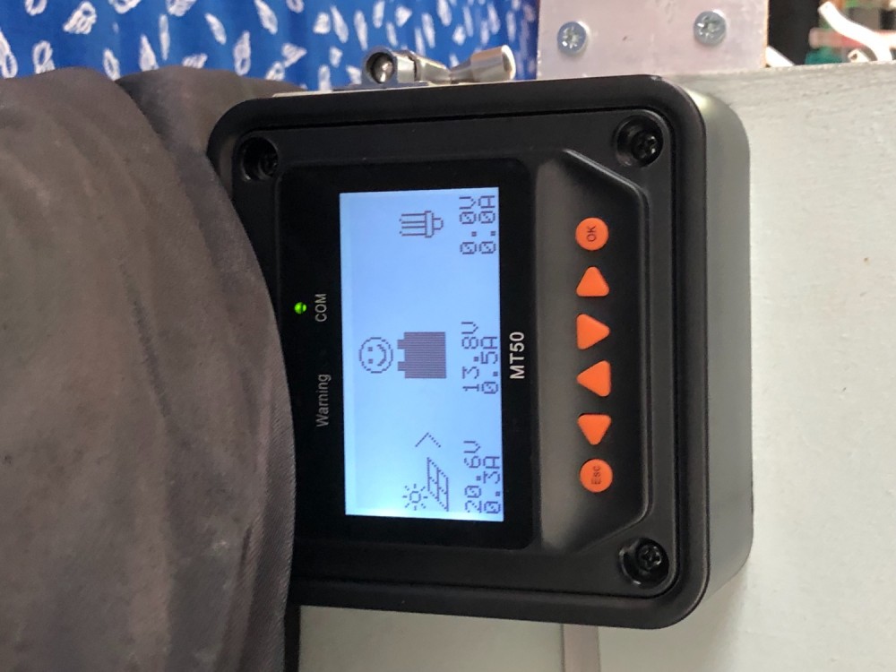

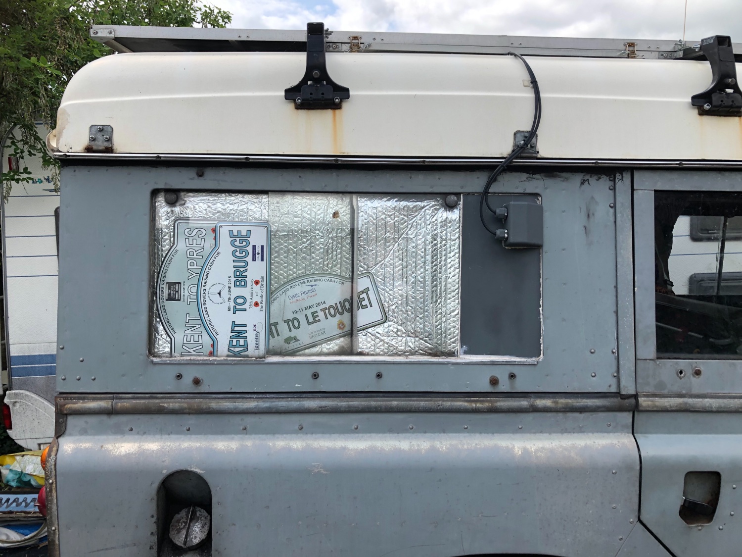

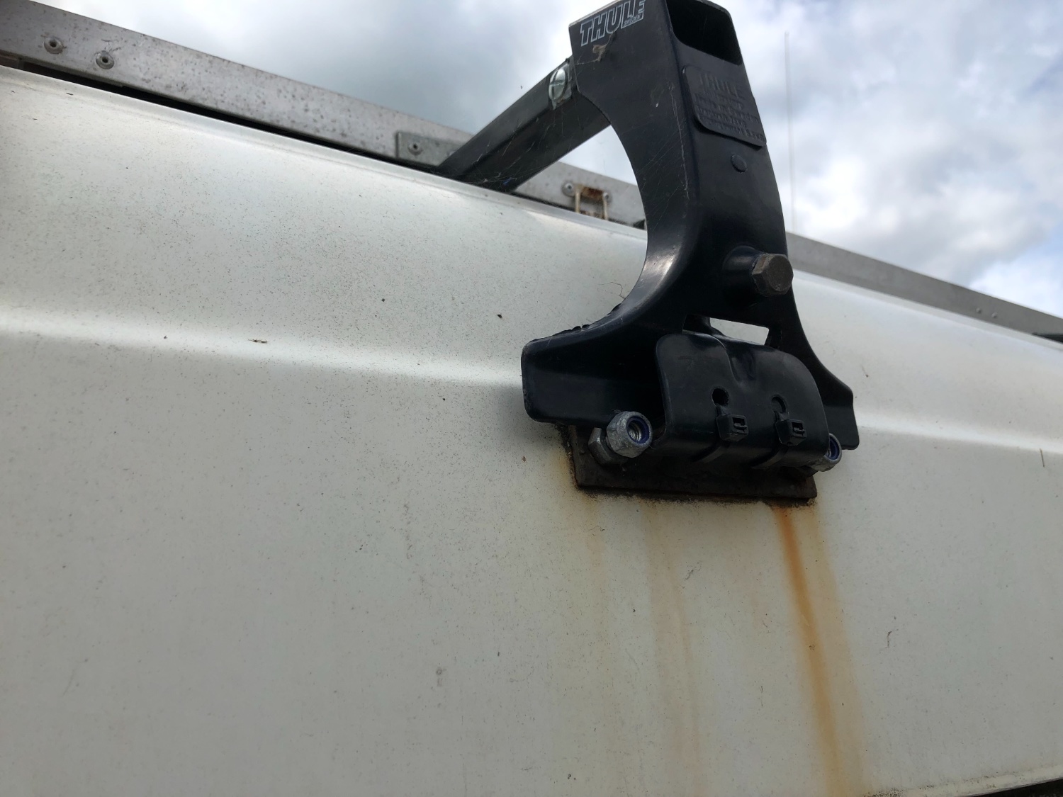

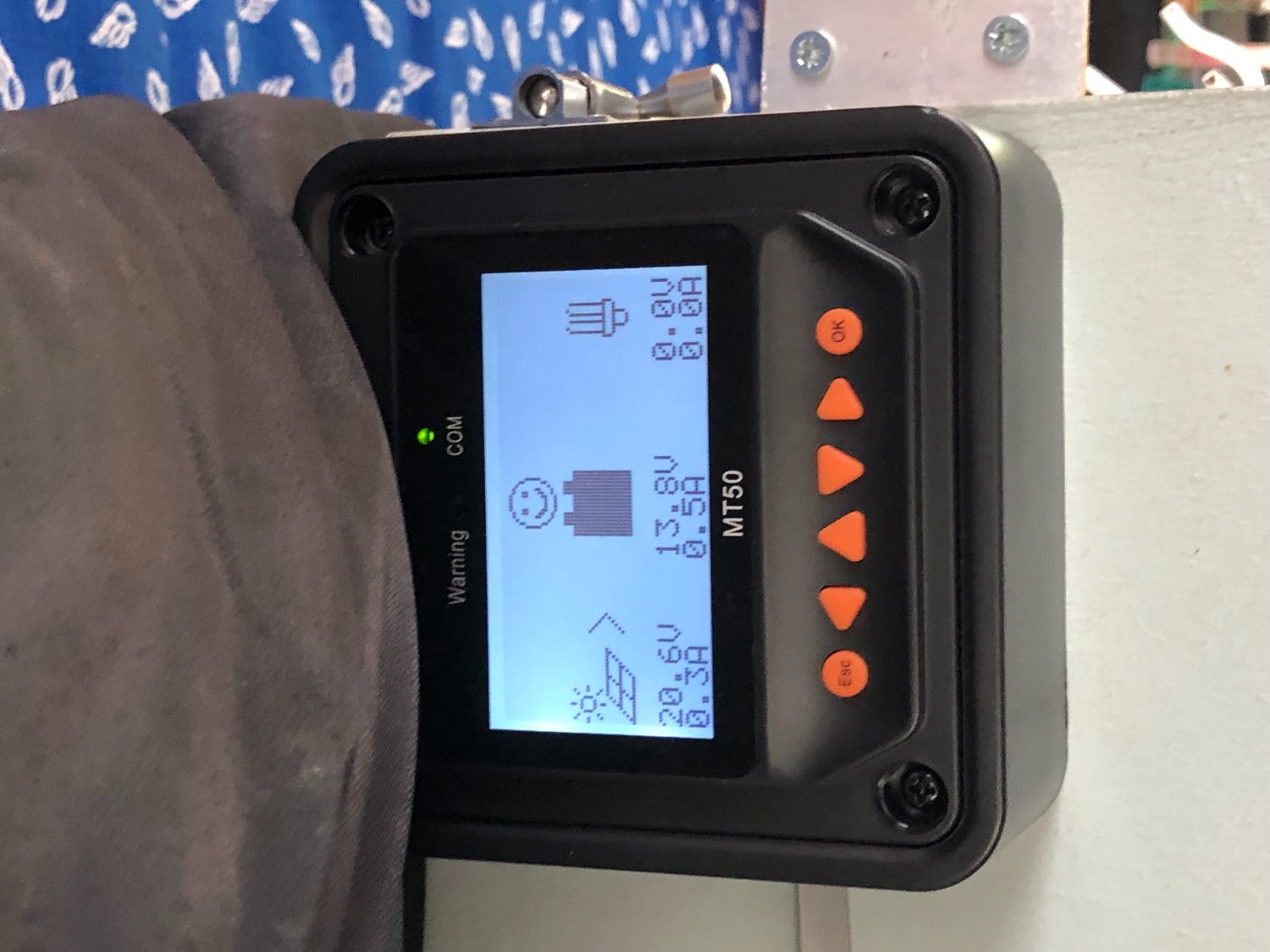

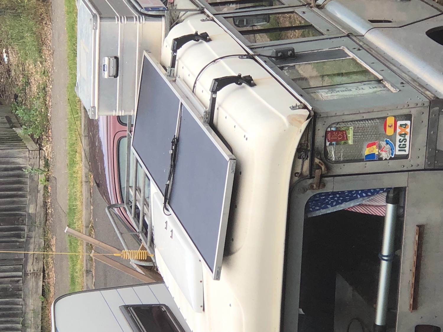

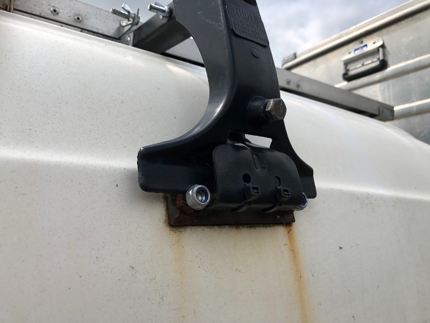

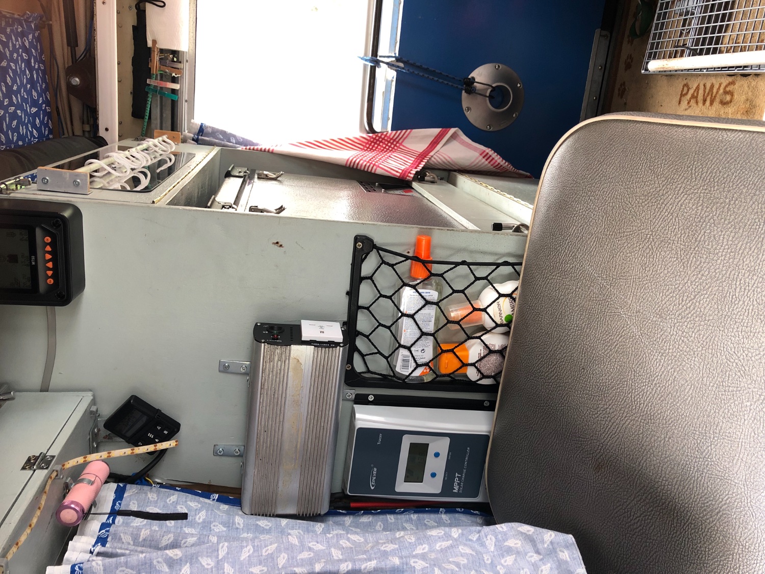

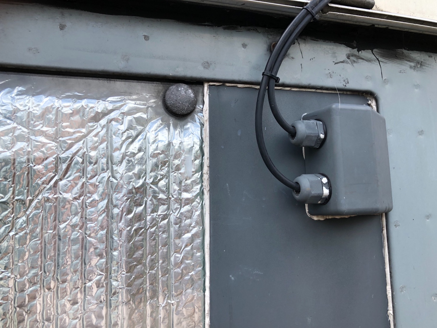

This is my setup. 220watts on the roof. 110ah leisure gel battery.
The solar panels I got from ebay from photonic universe. I have 2 of these each 110 watts, flexible (to save weight) with new etfe coating technology. Not cheapest, but this is where you should not skimp on. The frame is also tiltable at the top when the roof is open so it still sits horizontally to maximise the performance. I used existing bolts on the roof to attach it all.
