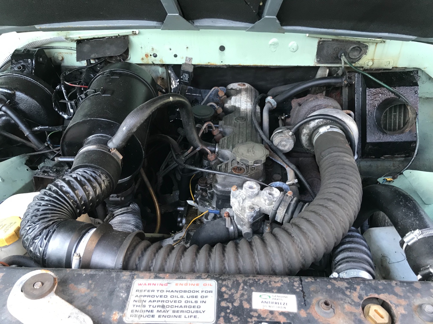

Nice looking carawagon :cheers: Would you have any pics of the engine bay ??

Post by Welshcarawagon » Wed Jun 19, 2019 8:26 pm
Picture of engine
Engine of carawagon
Engine of carawagon

not sure if my contribution might help but?
Like you, I've got a Defender 200Tdi in my Dormobile. I've used a K and N style air filter on the turbo rather than have those long Defender type air tubes and filter. Thinking maybe when your turbo slows on those downhill sections it cant pull enough air?
Only a though - kind regards Chris
