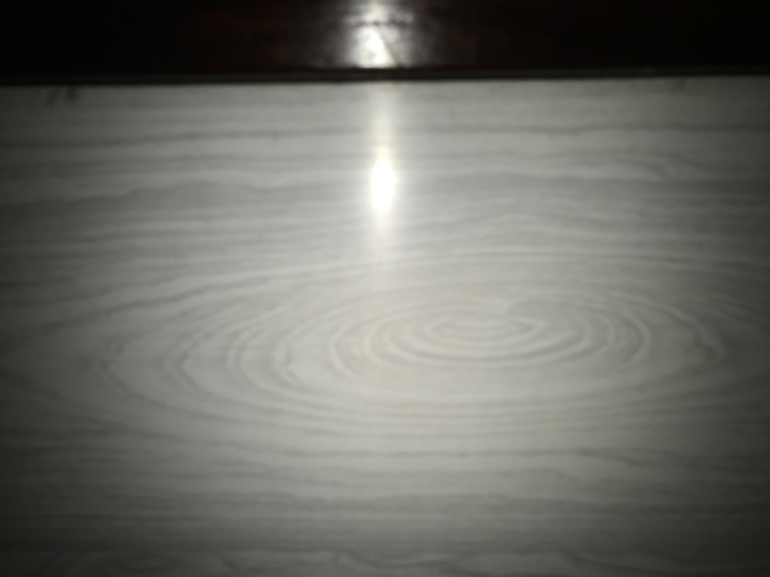

With nowhere to go and no prospect of adventuring in the next few months I decided to remake some of the butchered Carawagon furniture the previous owner had a go at with a nail gun, red laminate and glue.
In pulling apart the side cabinet I found that they had stuck the reddish laminate over the top of what may be the original. A white wood grain pattern, the photo is one of the kick boards, about 10 inches tall.
Original laminate?
Original laminate?
holly original laminate.jpg (64.85 KiB) Viewed 42091 times
First question, is this the same as other Carawagons?
I remember they are usually white with a grey pattern, but I don't recall such a distinct wood grain. I think it's totally smooth but being covered in adhesive it's hard to tell for sure.

But today I've actually managed to peel off some more of the red laminate and the surface underneath isn't that bad. Unless there's some horrors lurking under the bits I haven't got to yet, I don't really understand why it was covered over in the first place.
After trying various solvents and thinners on the adhesive residue, I found WD40 specialist degreaser dissolves it really well so I am optimistic about being able to salvage the rest, in the blurry photo just that first square has been quickly wiped over with it.
holly original laminate 2.jpg (43.05 KiB) Viewed 42064 times
My new plan is to try and build something vaguely similar to what I think the original was but to suit my requirements, and if I can then I'll reuse the white wood laminate panels.

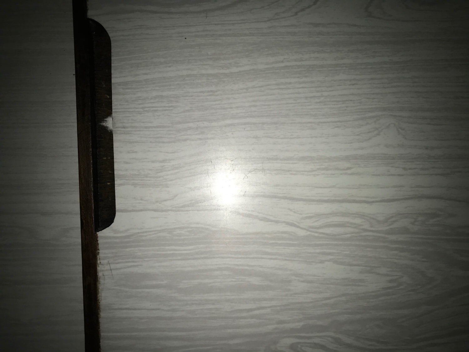

Welshcarawagon
Posts: 44
Joined: Mon Jul 28, 2014 9:46 pm
Re: Carawagon laminate - all the same, and modern equivalent?
Post by Welshcarawagon » Sun Apr 12, 2020 11:27 pm
Went out tonight and took these photos- not the greatest in the dark!
Our interior is mainly original and looks like you photo
Hope it helps
As for modern replacement not sure but maybe vehicle vinyl graphics firms? They may be able to replicate pattern and then sick it on? Just a thought
Phil
Post by Peaceand » Mon Apr 13, 2020 9:31 am
Thanks Phil, that's exactly what I needed to confirm that it's the original surface.
I'm still planning to reuse the worktop, but as I uncover and clean more of it I'm finding there are bits of damage here and there. So I've ordered a roll of stick on vinyl with a similar pattern to stick over the top. That way if a future owner (or me) wants to go back to the original or do something different then it'll be a simple matter of peeling it off. Time will tell how well it lasts, and if it looks anything like the original.
