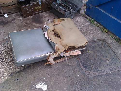

Well liberal amounts of easing fluid and enough weight to end up on my face when it decided to work :laugh: You will see it needs recovering but at least it is A. working and B. exactly right for the year of Dormi! Thanks Graeme//

There is a bit of a design flaw with the Dormatic seats when folded flat to make the bed(s) as Mick has hinted at with his inflateable mattress.
You will probaly find that the bed drops slightly between the flat rear seats and the flat front ones. For me, this step co-incided with the small of my back and always caused me to squirm about, readjusting my postion on the bed to try to get comfortable.
As you have the seat off it might be a chance to refit it with some spacers underneath to permanently raise it's height. I have done this with Dormy and now enjoy a much better nights kip with no achy back in the morning. I lifted Dormy's drivers seat as much as 3/4" though I can't remeber exactly how much I can check if you want.
I still need to raise the front passenger seat but hope to achieve this by just packing 1/4" under just its rear seatbox rail, as the difference is much less and won't then affect the front fixings.
An unforseen advantage of raising the drivers seat is it now clears the lip on the rear of the seatbox and allows me to slide it further back. I find this gives me a much better driving position with my (slightly) longer legs and more room to the steering wheel too.
