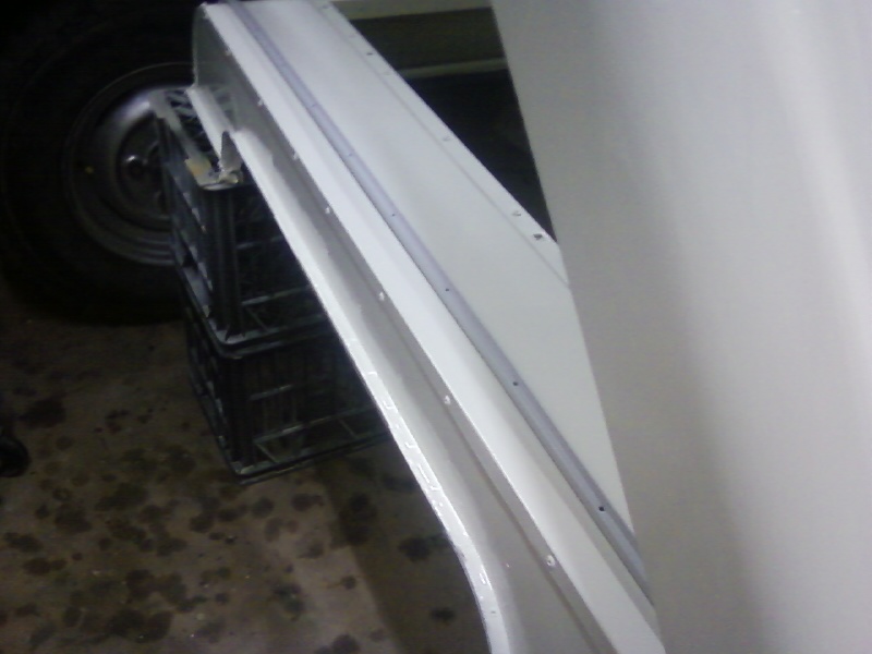

The strips on my roof were fitted outside the canvas and were sealed with some strange putty type sealant, I'm trying to fit a new canopy to my roof at the moment but I'm finding it impossible to get it sitting correct like the original
I just cannot get the stripes horizontal
so I might just refit the old one and paint the inside of it with some flexi paint.
I assume you mean these aluminium strips
