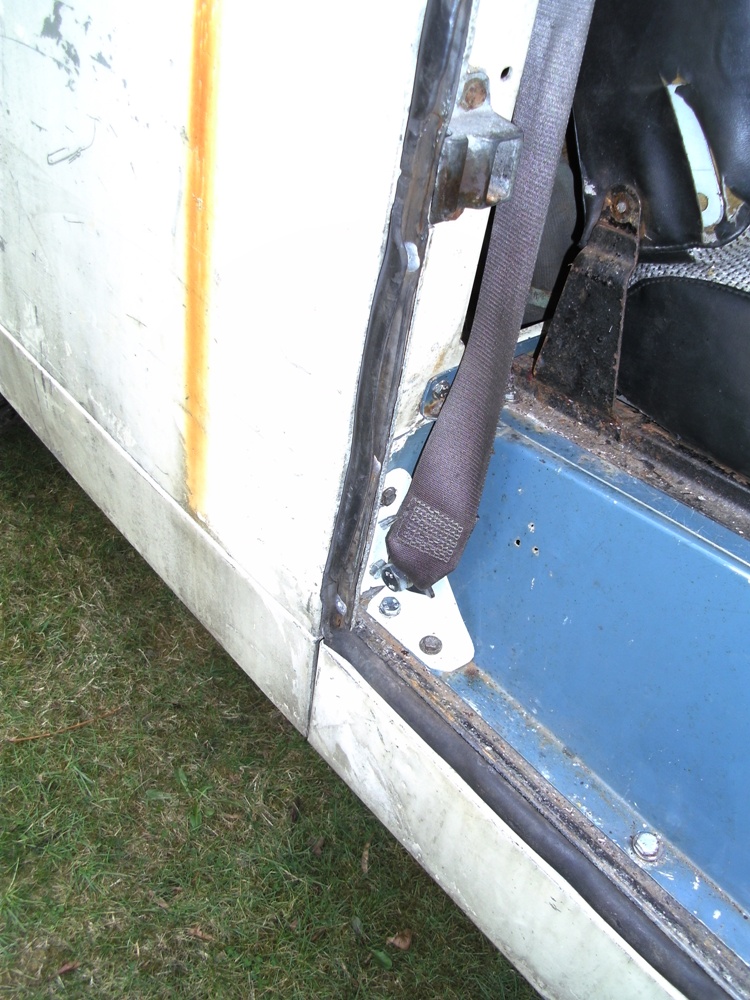

Yesterday, I bolted in the seat box (it wasn't fixed in!), seat runners and fitted the seats - it looks a lot more like a roadworthy Carawagon now
I also topped up the gearbox & transfer box before I put the tunnel and floor plates in - and remembered to fill the front axle (after I replaced the diff a couple of days ago) while I had the EP90 out.

I just need a couple of bits to finish putting the inside front together (bulkhead to tunnel panel & lower seatbelt mounts) which I'm hoping to pick up today from a friend, then I think it's ready for MOT
