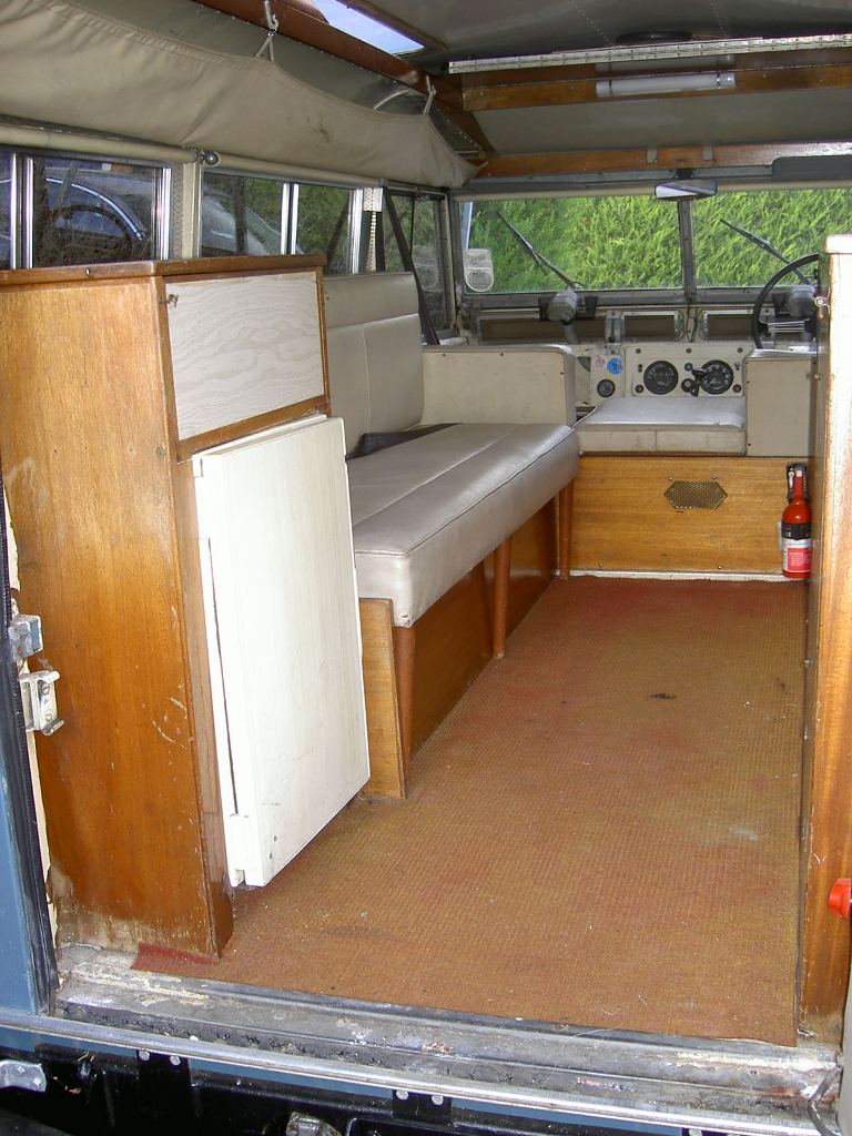

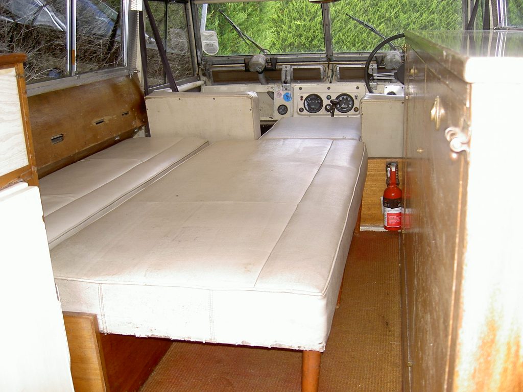

Hi Matt,
The Carawagon seats are generally separate squabs and backs which are not permanently fixed and can be moved into different positions.
For example, in the standard 2 door 109" Carawagon, there's a plywood/blockwood base in the back with a long bench seat squab which fits on top using blocks of wood underneath to locate it. When using it as a bed, the bench seat pulls out towards the cupboard, and is supported on three legs on the 'pulled out' edge and the wooden base at the back.
The seat back then drops down horizontally to fill the gap between the squab and the side of the Carawagon.
There's a 6" or so gap between the bed and the cupboard.
The front seat arrangement is to remove the squabs from the passenger and middle seats, fold the seat backs down, then put the squabs on the back of the seat backs.
There are wooden sections etc. to locate the squabs so they 'lock' into position.
That's just one arrangement - there are others, for example the SW version like Patrick's and a twin bed version like one of my projects, and sometimes the centre seat is a cubby box with a padded top, but none of the Carawagons, as far as I know, use a mechanical folding system.
Here are a couple of pictures I have to hand - not one of my Carawagons, but they show the rear seat of a 'standard' 2 door Carawagon with the bed out and put away.
It looks like this one has the centre cubby box, and that the front passenger seat hasn't been folded yet.
Cheers,
Robin.

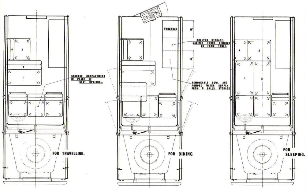

I'm sure Patrick will oblige when he next uses his, but meanwhile, here are some brochure images showing the arrangement for the Station Wagon version (Carawagon Ultimate Continental):
Dining:
Bed:
I do like the table lamp - I must look out for a similar one for mine
I must admit that, apart from the bed being a bit of a faff to set up compared to the 2 door version, Patrick's does have more usable space once set up due to the side door area, though it is has less cupboard space.
