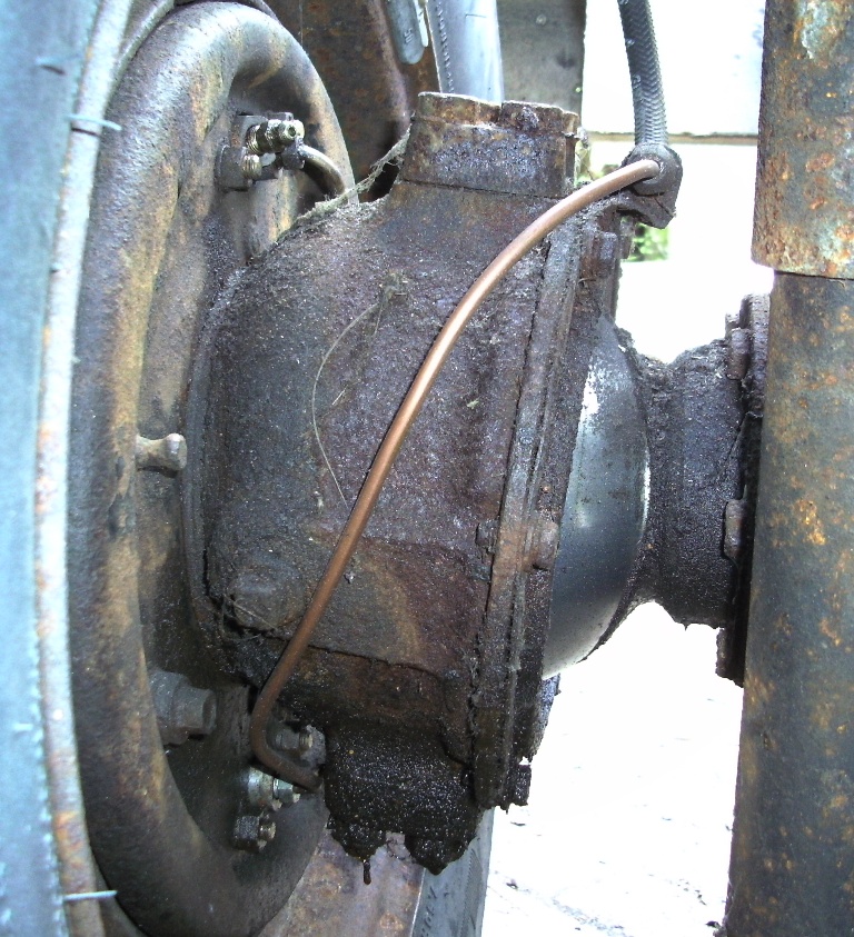

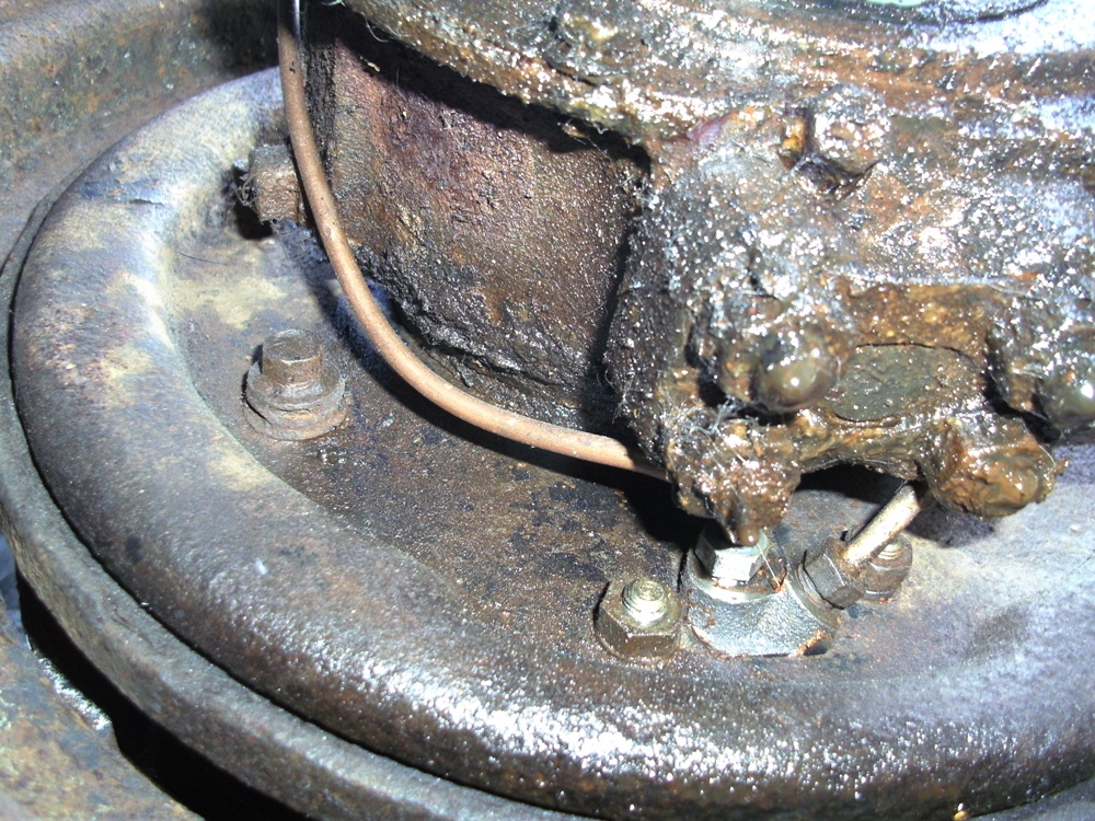

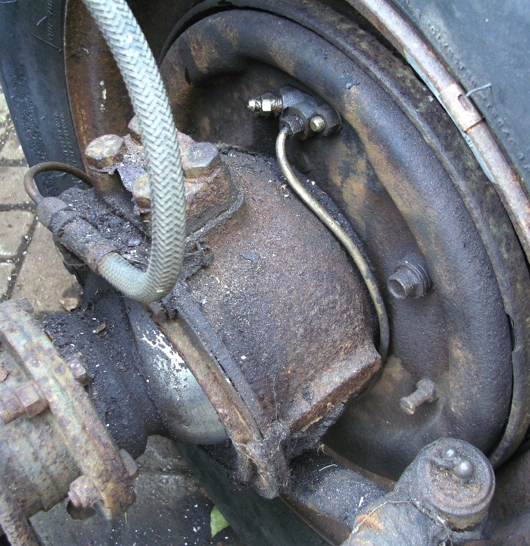

Another solution is to re-plumb the pipework, as below, so the bleed nipple is in the top cylinder.
Top cylinder
Bottom cylinder
This mod requires just one extra pipe to be made up, from the flexi pipe to the bottom cylinder, to replace the short one which went to the top cylinder.
The link pipe between the cylinders remains the same.
