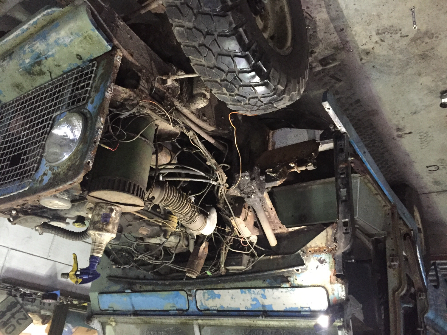

cut the foot well out the passenger side tonight. ready to fit the new one tomorrow.
do you still have your roof for sale.?

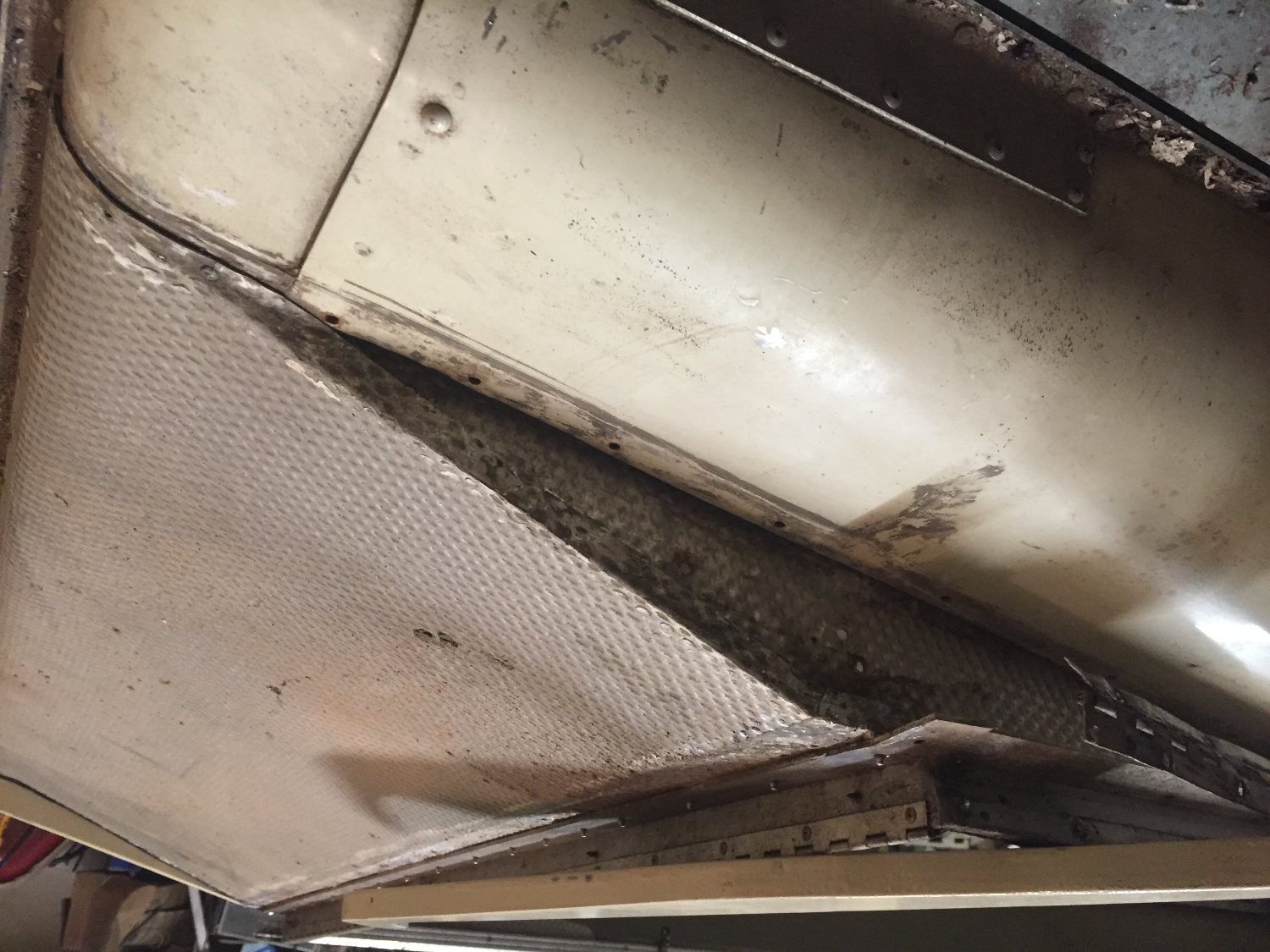

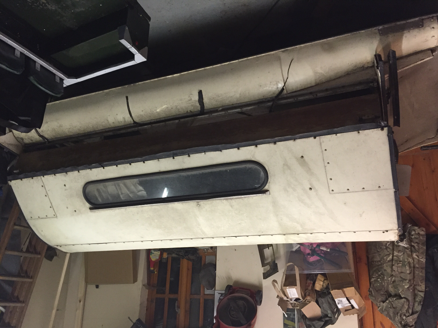

Last night started stripping the roof of refurbishment
Interesting things I found so far are can't make my mind up if the door would have had a roof rack at frontal the wood not been shaped for it?
It has a flock head lining its in great condition but a strange colour.
The wooden tray mounted at the front, which I've guess it's a child's bed? Both my boys fit on it perfectly. It dose look quite in keeping with the rest of the roof any ideas if this is original?
The side and transportation mounts are the worth parts with the end planels seeming to be in good useable conditions
All the seal are missing or be replaced with intertube that been cut into lengths

Good to see you already started on the roof.
Looks in better condition that I originally thought.
But... ehhh... I didn't know you lived down under???
It's very uncomfortable looking at those pics standing on my head...

This afternoon/ evening I changed the drivers footwell . It had been poorly repaired in the past with a tota of three repair panels put over the top of the original. The more i cut away the less there was to save. I ended up cutting the inter panel out of and remaking it. After a couple of trial fits finally got it in and painted. I remade the stenghtener that supports the pedal boxes .
