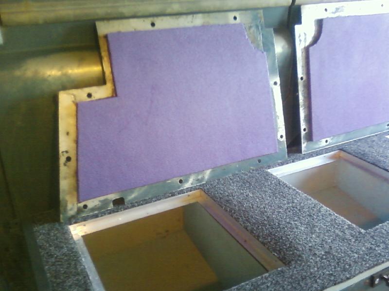

I've been having trouble with the transfer box in the dormobile and on my last off road day out, it decided to jam itself and is now stuck in 4wd high :cry: I've taken out the seat box and floor sections to have a good look at it, but I think it's serious and is probably long overdue a rebuild.
So while I'm debating what to do with the gearbox I decided I'd upgrade the seat box. I've removed the original locker from under the passenger seat and made a new box which is big enough to take two batteries and the air con fuses / relays etc. This is a bit of forward planning too for when I fit the 300tdi motor in.
On the driver's side where there was no locker, I've made a shallower box with a removable side to get access to the handbrake.I also want to fit a water tank under this box where the gas bottles were fitted.The original center tray has been retained but slightly modified.
I've made the new boxes out of mdf and have cut and glued aluminium sheet to the exterior faces. The insides will be covered in carpet. I've also made a new top with lids for the seat box, again out of mdf which will be carpeted. This does raise the driving position slightly but I find it better as I'm only little :grin:
I did a similar modification to my "Isuzu County" mainly as a soundproofing modification and was surprised how well it worked, so I'm hoping this will quieten down the dormobile too.
Here's a couple of work in progress prototype pics. I'll post a couple of the finished item when it's painted etc.

Neat idea. My concern would be the pong of damp when the MDF inevitably gets damp? My 6 pot Dormobile has underseat tank (ex mil) and center cubby holds Webasto heater. The 2.25 Diesel Dormobile will have the LPG gas cylinder cradle fitted. But - your work will be very much quieter!

I've wet proofed the mdf prior to fitting the aluminium and have also done inside the boxes, under the seat top etc. so I shouldn't get any damp smells or suffer from the mdf swelling when we go wading through rivers and creeks :-)
Before the final fit of new to old, I will seal all joints and then seal seat box back into vehicle.

A quick update on the seat box modifications, I completed the storage boxes and I also fixed foam sound insulation to the under sides of the seat box. I sealed all edges and have painted the underside in a black underbody spray. I also fixed sound insulation material under the removable floor sections and have sealed and painted these too.
I re fitted everything mainly to make sure everything still fitted, which it does :nana1: I then took vehicle out for a test drive and was really surprised how quiet the vehicle has become :stars: It's hard to describe but the soundproofing seems to have pushed the noise forward into the engine bay :? I no longer hear the gearbox / overdrive screaming either and it's actually quite civilized to drive.
As this has worked better than I could have hoped for, I'm going to fix this material to the doors, rear floor areas,behind roof lining, bulkhead, under bonnet etc. etc. Hopefully I'll end up with a reasonably quite drive.
Here's a couple more pics of work in progress, I didn't take any of finished item :wine:
