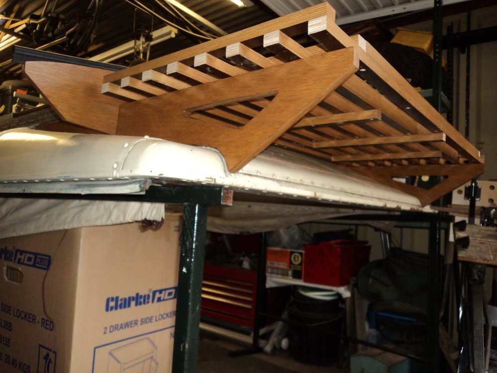

I made the roof rack sections quite a bit longer than original on both Patrick's and mine, to give more rack space, as you can probably see from this pic as I was assembling mine:
Of course, I wouldn't put anything really heavy up there - if I was going to put spare wheels and jerry cans of fuel up there I'd get one of Mick's metal racks!
When I put the big roof box on, for long expeditions, I support the front with bars down to the windscreen hinges:
Then again, I'm not particular (on this one, anyway) about keeping it original, otherwise I too would have made the rack as original, oh, and stained before varnishing.
I think the holes in the sides of the rack are possibly there for letting air flow through when the rack is loaded otherwise it could become an air dam, and probably to save a bit of weight as well

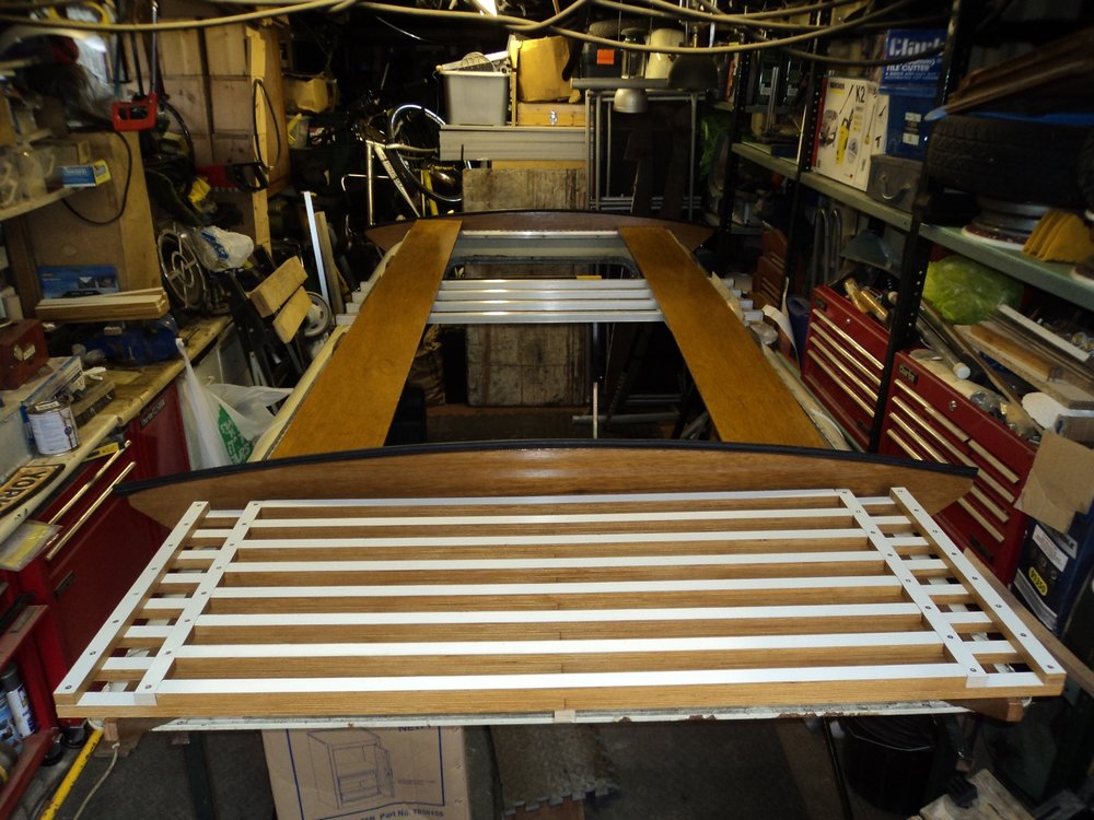

Good and bad news today. Unfortunately, I've been evicted from the borrowed barn...he wants to get on with a project of his own but that inspired me to get up and tidy 20 years of clutter from the first end of my own garage. Once I'd thrown and stacked it all at the bottom end I went and fetched the metal frame/roof. It was so much easier to get it on the roof-rack with all the wood and aluminium missing.
I can't believe I'm going to ask this of you all.......but would you like to 'rate my rack!?'
I'd already stained the wood on an earlier evening in the house. I have got an aluminium rack that came with the carawagon....but it's only 1.2m by 0.4m, just 4 bars.....and looked home-made rather than factory anyway. I've preferred the wooden ones I've seen so spent the afternoon cutting and screwing. I think it's come out OK. I just need to stain the ends where I've made cuts before I yacht varnish the whole lot. It's got 8 bars and now measures 1.25m by 0.52m......every little helps they say. I've done it early in the project beause I would have rushed and made a mess of it if it was the last thing to do.

G'day matey, Nice in fact it is very nice and a pleasure to look at
