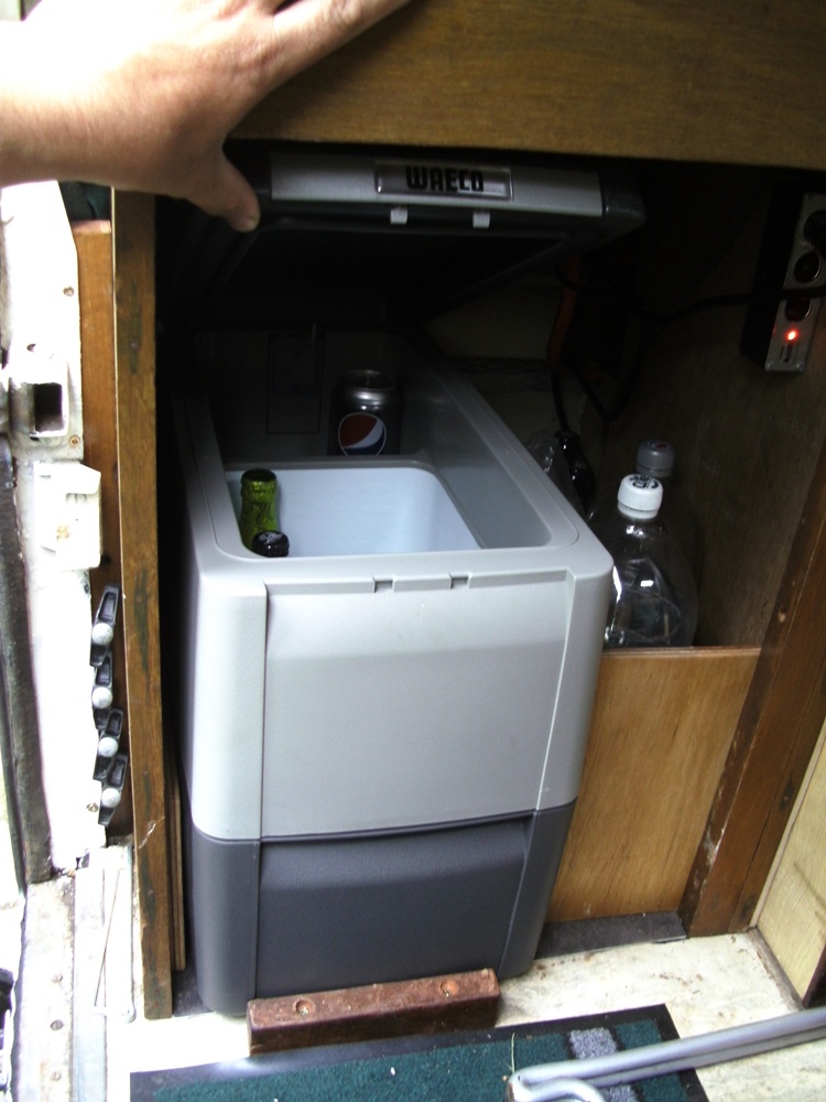

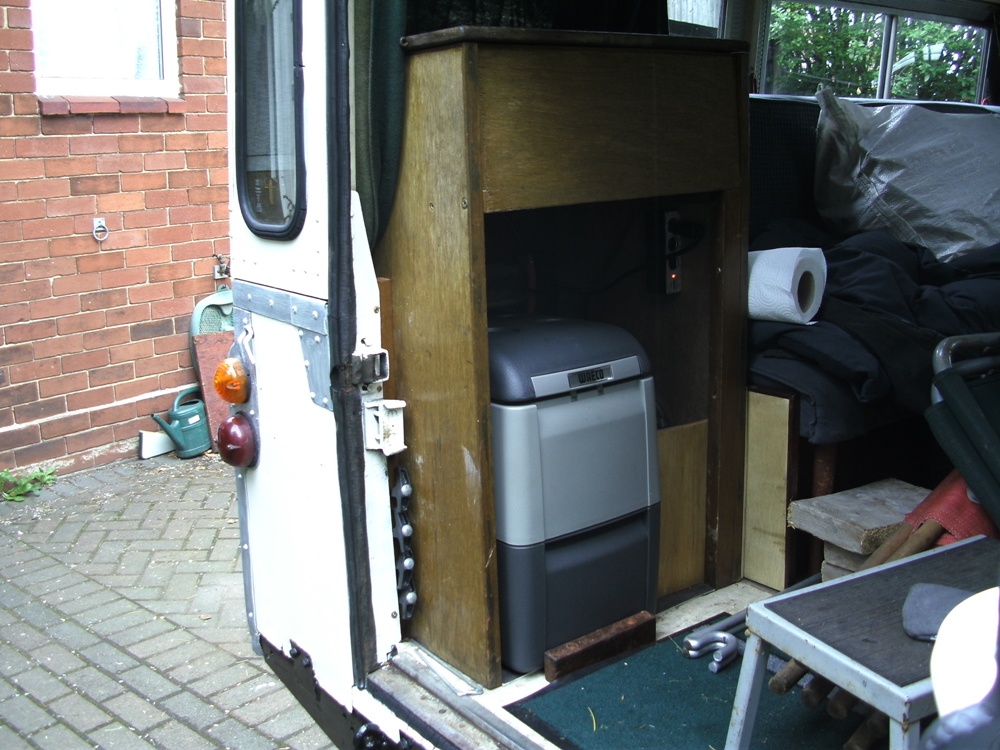

So, I've splashed out and bought another Waeco compressor cool/freeze (we've already got one in Patrick's Carawagon).
I chose the 25l one as the lid opens the right way to mount it in the space where the old fridge was, and it leaves a nice space down the side for bottles etc.
For those of you who don't know about these fridges, they can cool down to -18C as a freezer whatever the outside temperature is, and they sip 12V like good wine
These (and the very similar Engel) fridges are the choice of many who take on long overland expeditions.
