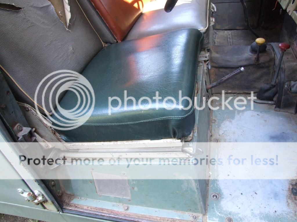

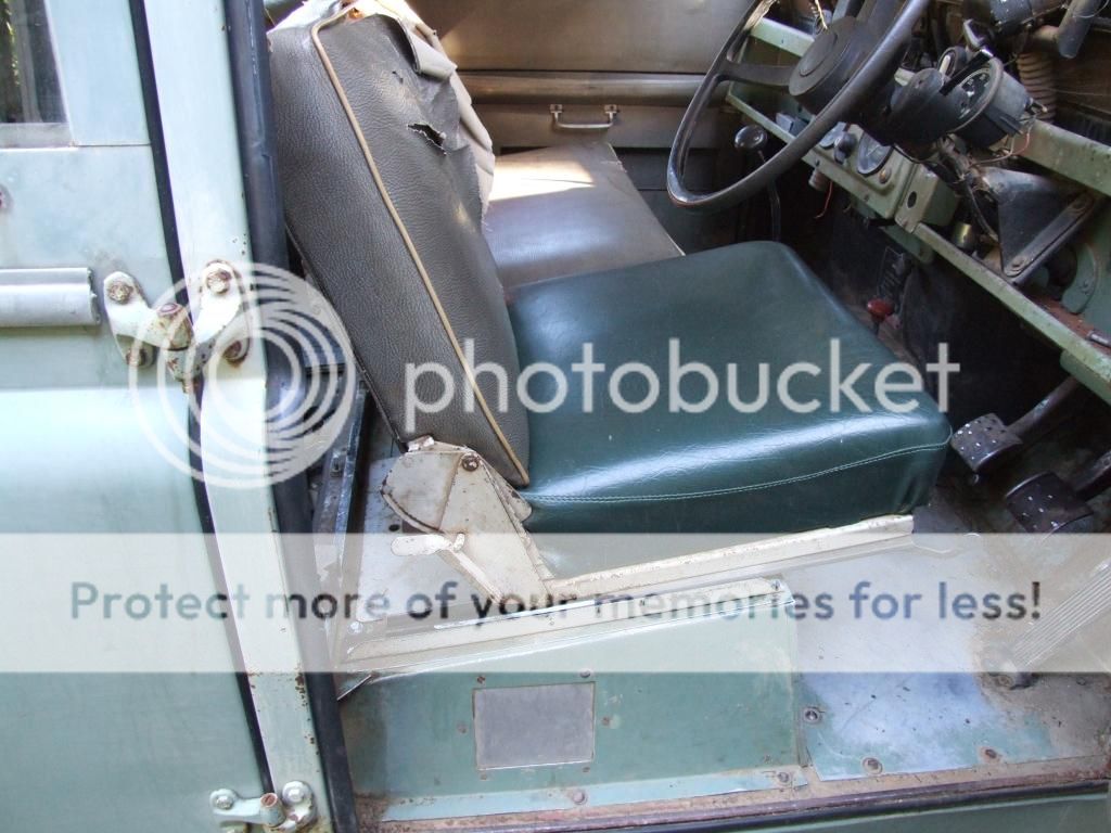

Post by jerryd » Thu Feb 05, 2015 9:56 am
Belated welcome Colin :wine:
Your driver's seat assembly/runners doesn't look standard equipment, the seat runners should have a 90 degree slotted angle at the front which drops into a thumb screw affair which is fixed to the seat box :stars: The rear of the runners sits under a slightly raised bracket , again fixed to the seat box.
The idea is to undo the thumb screws, lift the runners slightly and then the whole seat lifts out to gain access to the gas bottles in the holder under the seat. A bit hard to explain and I can't find a pic, maybe somebody else has one.
I rearranged my seat box and have three storage compartments instead, with lids that are easily lifted for access. There is a thread about it somewhere in the technical section.
Re: Walter the Dormobile
Post by jerryd » Thu Feb 05, 2015 10:13 am
Just found this pic of my spare passenger seat, although not in a runner as per the driver's seat you can get an idea of how the runner should look with the folded section at the front.
