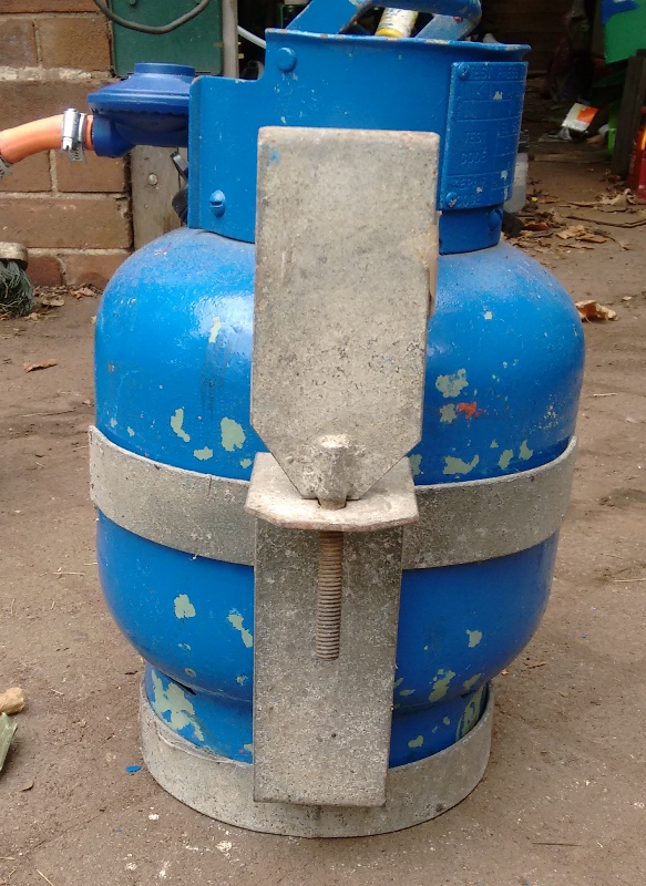

They are indeed a tight fit on the bottom ring, but no modification was necessary! It had two butane bottles fitted when I got it, one of which it still has (still need to exchange it!). With a bit of foam around the middle, they fit very snugly and tightly with no rattles!
Re: Gas bottles

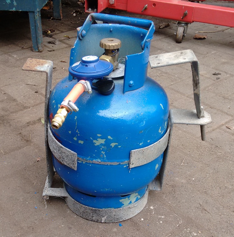

Ok, I wonder if there were different carriers depending on which bottle you ordered?
I have a 1972 price list which shows two optional extras of Calor Cylinder 10lb and 'Gaz' Cylinder 6lb 2.7kg.
Anyway, a Calor 3.9kg bottle almost fits the carrier I have here - interesting that the base of the Calor 3.9kg bottle I have here measures 7 3/4" - the ring it is supposed to sit in measures 'almost' 7 7/8" inside so the bottle is a very tight fit - as Calum said.
However, the arms of this holder wrap around the Calor bottle nicely.

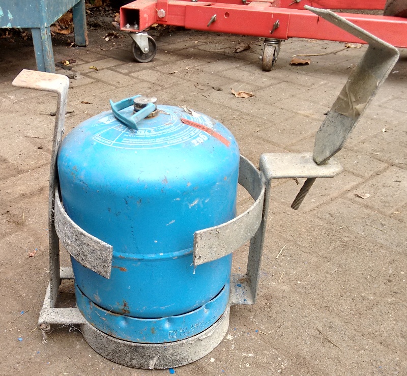

A Camping Gaz 907 cylinder is quite a bit narrower in the main section, but the base ring is 8" so even more out of sync with the carrier ring.
Hopefully over the weekend I can get up to measure Patrick's - I was pretty sure the 907 cylinder was a good fit in his and that a Calor 3.9kg wouldn't fit, but I'm old and my memory is failing
I'm also pretty sure Patrick's has a hasp/staple arrangement for a padlock and not the threaded rod like this one, which presumably would have had a wing nut?
With Calor 3.9kg cylinder:
With 907 Camping Gaz cylinder:

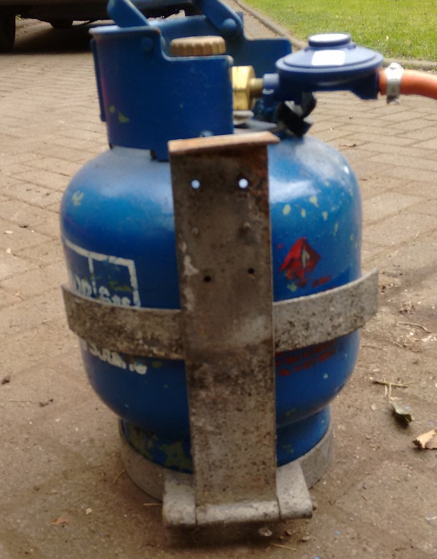

As it would be attached to chassis rail - dropped for changing cylinder:

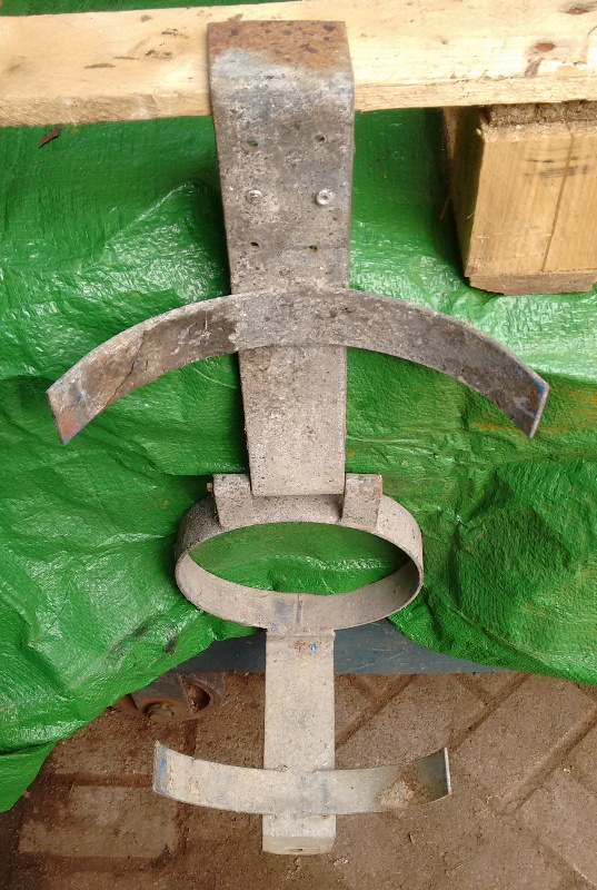

Anyway, measurements are as follows:
All steel is 1/8" thick.
Base ring is 7 7/8" inside diameter, 1 1/2" deep
Fixed side is 2 1/2" wide, bottom bend is 1" welded to ring, overall height between bends is 7", top bend is 3"
'Catch' section is 2 1/2" wide, 5" long plus threaded rod, top bend is 3 1/4" long.
This is rivetted to the underneath of the floor, I think.
Hinge tabs are 1 3/4" long, 1" wide
Hinged section is 2 1/2" wide, 11 1/2" long between hinge and top bend. Top bend is 2" long.
This is the section which is rivetted to the chassis rail, with the top bend on top of the chassis rail.
Supporting 'arms' are 1 1/2" wide.
Hope that all makes sense
