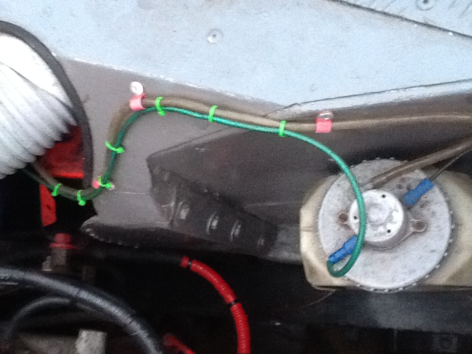

AS usual my OCD of trying to lay thing's out to look tidy got the better of me :banghead: , my spare coil that was bolted to the bulkhead beneath the rain channel was removed so i could lay my extra small loom's against the main loom so although colorful will at least be tidy.
The relay for the old style split charge can now be bolted to the riv-nut's i fitted earlier, with the loom's in place i am in the process of making another bracket the same as the one for the relay to fasten a standard landrover series 2a fuse box to that will take care of the live feed's for my system.

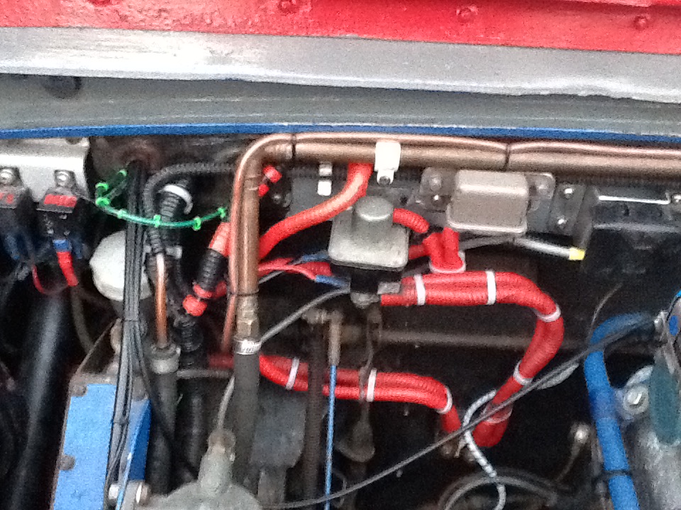

Well chap's, having had to back off a tad due to the weather and the fact i took off the relay bracket to make another identical, it turned out i had to make two having made a mistake with my measurement's :embarassed: .
It's nothing knew for me but i did get a tad frustrated when i realized the 2a fuse box was a different shape and size :banghead: , the fact i had spent hour's cleaning the fuse box and didn't realize :thud: just show's how engrossed i was in getting it clean without dropping or just breaking it.
Unfortunately i had to take off the coil and electronic ignition that was mounted on the rocker box military style, i could then get to the part of bulkhead i was going to be working at with my drill and riv-nut tool.
I measured-marked dot-punched and drilled the mounting holes in the now proper shape and size bracket which allowed me to mark the bulkhead prior to drilling in stages the holes for my riv-nut's, with that job done and having found some nice allen screw's with washer's it was bolted in place :nana: .

After a brew and a short trundle with my hound it had started to brighten which meant i could at least prepare my thought's of my plan of action {at least it sounds positive :wink: }, rather than struggle i took off the mounting bracket for the 2a fuse box then marked and drilled the relevant hole for the center mounting riv-nut, this allow's me to use a nice set screw and shake proof washer with a dab of copper grease which i have failed to mention i use on almost everything.
With the fuse box fastened a small hole was drilled in the bracket that lines up with a small cut away in the base of the fuse box, a small self tapping screw is screwed in the plate to act as a locating pin.
The rest of the day which to be honest was not a long time was spent soldering some terminal's and re-routing a few wire's that i was not happy with till i just had to call it a day :banghead: .

Anyway today with this tube thing fitted i decided to protect the petrol pipes from any damage caused by anything metal chaffing and me not noticing.
I had dug out some conduit off old wiring harnesses the size of the fuel pipe which has a slit in it for easy fitting, with that done i bound the pipe encased with conduit from end to end fitting a cable tie each end to stop it unwinding.

More photos.
