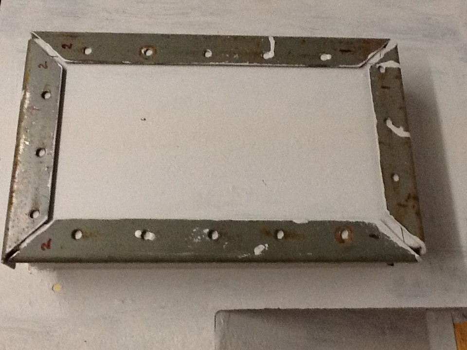

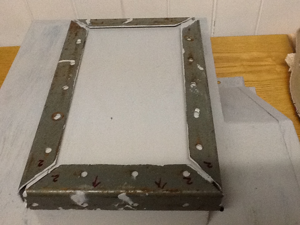

Post by romanyrose » Wed Mar 01, 2017 10:25 pm
Well chap's, what do you think :whistle: , having been called a wood butcher and now a bodger, i can't understand for the life of me why :shrug: i guess because i used the word dexion they must have imagined what they would have used it for.
As i have mentioned Mr Rust has been knocked out and treated, although again as above i had made these angled part's in alloy i felt it just was not deep enough. In my mind the battery i am fitting is a heavy little tinker, the last thing i want is for it to drop out of the bottom for what ever reason and cause a short, or just leave it for someone to run over {motor cycle} and cause an accident.
To my eye's anyway the holes look as though i have drilled them at equal spacing's, however the 45 degree angled cut's proved more of a problem to my easerly confused brain :stars:, i think i have cracked it with a bit of patience a few brew's to give me confidence that i have very little of.
Because the mating surfaces are painted in anti rust paint {used on oil rig's} tomorrow i hope to fix everything in place with a type of silicone between and loosely bolt it together before riveting her up :woohoo: .
With the excess silicon that has squeezed out cleaned up i can then give it another coat of paint and go on to the next job, making a mounting bracket for fitting my Anderson female socket to that i found while looking for something else :wink: .
For those who might not know what an Anderson socket is :shrug: , it's to enable people to jump start car's off with a flat battery using only one set of large crocodile clip's if that is what you call them :embarassed: .
