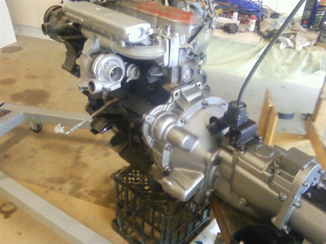

I've already got the 300tdi motor ready to drop in the dormobile , but having this one parked outside means I know where everything should go when I do the swap over :tiphat:

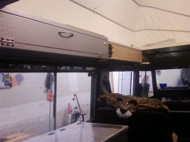

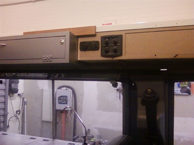

I've tried to do a few sneaky upgrades on my dormobile but keeping it looking along the lines of "original". As they are so rare over here I don't think anybody would notice anyway. There are a few posts in the technical section with a few pics here and there, but unfortunately most of the pics I have are still on my old broken computer :stars:
A few things I've improved to make ***** star accommodation :laugh:
The seat box mods were a great improvement for storage and soundproofing.
A deeper "spice rack unit" above cooker now houses a four person dinner set + cups etc. Also made two lockers above rear seats. These house the switch plates for lighting, fans, fridge, tv, water pump, compressor etc. The lockers also have led lighting fitted underneath units.
A deeper and wider wardrobe unit, can house the fridge and stores the table. Also has tv/dvd player fitted to end panel.
The kitchen unit now has a spring out drawer fitted, so easy to get to the baked beans now :eatin:
External shower fitted , 42 litre water tank / pump, filtered water to the sink.
Defender front and rear seatbelts fitted, I still have to finish the trim panels around the rear seatbelts though.
I'm now making a compartment for a small gas bottle which will be accessed through a little door, under the rear light area. The original gas bottle arrangement wasn't legal here without lots of $$ to get it certified so I removed it.
I still have lots of things to complete, but each job I've tackled has made camping a bit more refined. :tiphat:
A couple of pics of my trial locker construction to give you an idea
