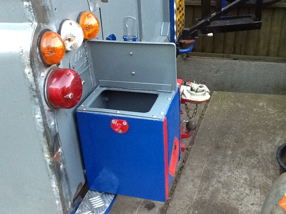

Regards the gas bottle storage box i have sorted out the 12 set screws needed to hold the top in place but the paint was still drying so could not be shown in the picture but when it is fitted half the lid lifts up so i can turn the gas on or off, this however i will show at a later date when it is all bolted up.

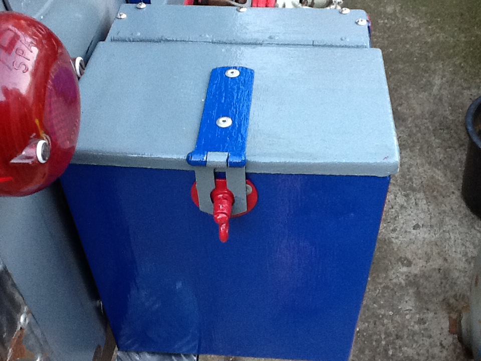

G'day chap's although a very busy sort of afternoon after waking up very late morning with the unopened yogurt still in one hand and spoon laid on my bed :shrug: i did manage a bit of tinkering on HEC by finding and cleaning up the hasp i think they are called which is the bit that holds the lid down along with a turn buckle.

G'day chaps, after assembling the top onto the box with the hasp and everything riveted nicely in place it appeared because i had used riv-nut's but not counter sunk screws when the lid was shut i could not turn the buckle to hold the lid shut :thud: .
I like the screws i had chose so it was a case of filing the hole the turn buckle fits through a tad longer which of course meant the galv was no more :shrug: but then having scrapped thick layers of paint from the hasp some anti rust paint turned it black undercoat along with the top coat was applied and it was left to dry in the sun.
Time to sort out some new terry clips to hold the door supports in place after i had made my own due to my canopy being fitted a tad different :wink: by which time my painting was dry so the hasp got riveted back on and i must say my colorful painting does stand out a bit :laugh: but i am happy with the end of another fruitful day.

Well chaps, :wink: i have heard say bright colors help one wake up in the morning :shrug: but in my case i am really happy how that battered old box i have had for years has turned out and will be put back in service but maybe not what it was originally made for.

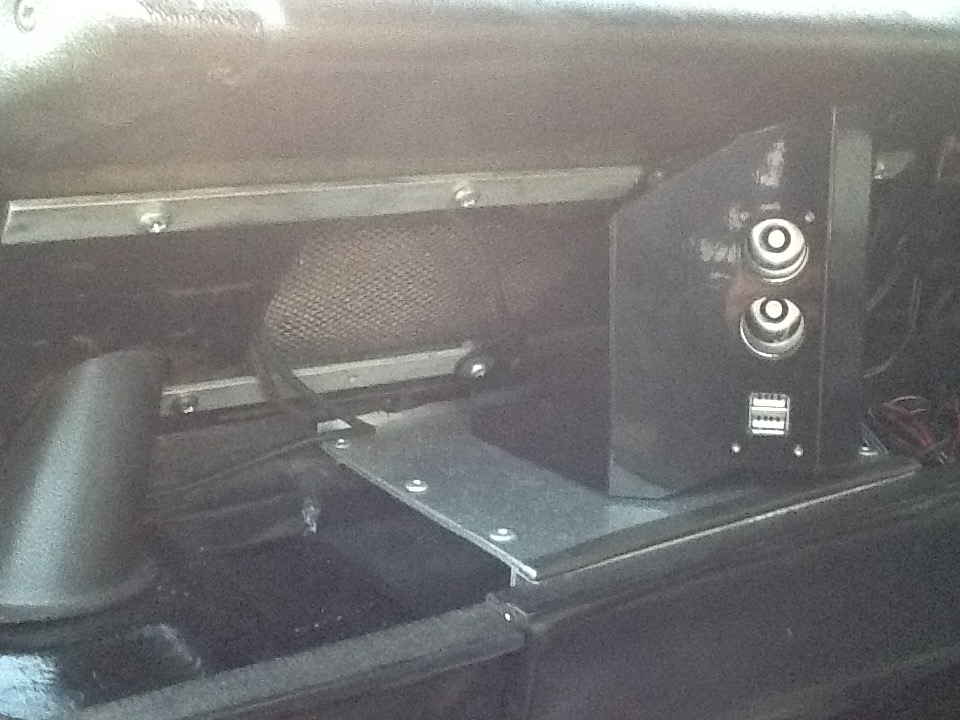

As you can see i have fitted an e.bay purchase that a member bought for me for the sat-nav etc but i have kept my cigarette lighters that are extra on an alloy plate that's part of the dash for now anyway :shakehead: .

:whistle: a change of mind saw me take out the alloy plate that housed the cigarette lighters in the series three dash for an alloy plate the same shape but was now the home for three switches one of which illuminates to let me know the USB come power points for the SatNav etc are turned on.
Yes maybe power from the ignition switch might have been easier but that's to straight forward and the other side of the truck and to be honest a series three bulkhead is not as easy to work with unlike the 2a bulkhead it should have on :wink: . To my late father the type of bulkhead was erelevant as long as it did the job and was something to tinker with is all that was important so it stays as it is even though i now have a correct type it matters not to me.
With big black clouds building up in the distance i just managed to complete the job with everything working as it should and i have a small switch with wires soldered in place with a bullet connector on each end just incase one day i might need an extra switch to power up what ever takes my fancy :laugh: .
