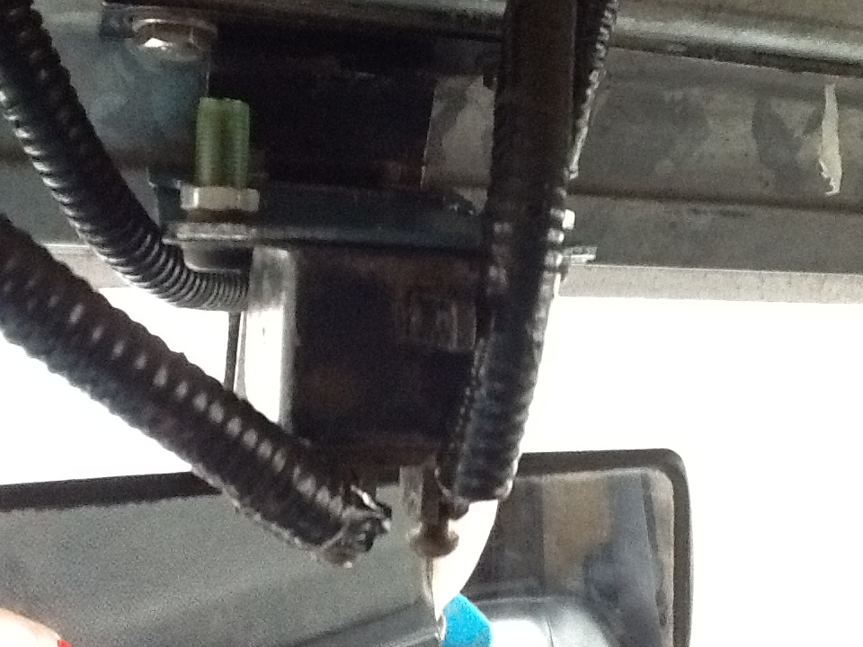

Post by romanyrose » Fri Oct 16, 2015 10:41 am
G'day chaps, well i have to say everything is done regards getting the steering box ready for fitment after rubbing down the scratches i made to the column when first having a bash without moving the support from the chassis to the column.
Anyway i knew i had got a wire off the ignition switch from when the column was being extracted [series bulkhead remember] so while the paint was drying on all the bracketry of the column i connected the wires tidying them at the same time :thud: i am now confused as my electrics don't work as they did so i must have made a mistake :stars: .
Marty could not help in anyway and with me fitting relays to anything that needs a good bit of power to work it he walked away saying not a chance or words to that effect :laugh: .
Anyway a bit more refreshed in my mind and having put it down on here it sort of helps me cope and realize what i might have done wrong so sorry for the waffle but only i understand my complexed mind and the way it works which is pretty hard for me sometimes even though i have lived with it all my life :thud: .

Post by romanyrose » Fri Oct 16, 2015 7:53 pm
G'day Robin, yes after a chat on here a brew or two then let my little dog take me for a wonder after which a sit down and another brew one step at a time i started but in the end it was a case of looking for my magnifying glass to see those numbers on the relay :shakehead: .
Half an hour later i found it in a safe place so i didn't break it so it was a case of draw a larger picture of the relay with terminals numbered for what goes where but then i had a phone call to say Jonny my helper was coming round :banghead: now i am not being nasty but give him some bricks to smash or pallets to take apart he is happy but other than that he talks rubbish or words to that effect bless him.
Anyway not one to give in i tried to carry on with the thought of burning daylight but in the end even after he had gone what concentration i had has gone leaving me :stars: not knowing which way to turn but my dog had the best idea which was to pack up and go and sit in the park with here so i could just relax.
