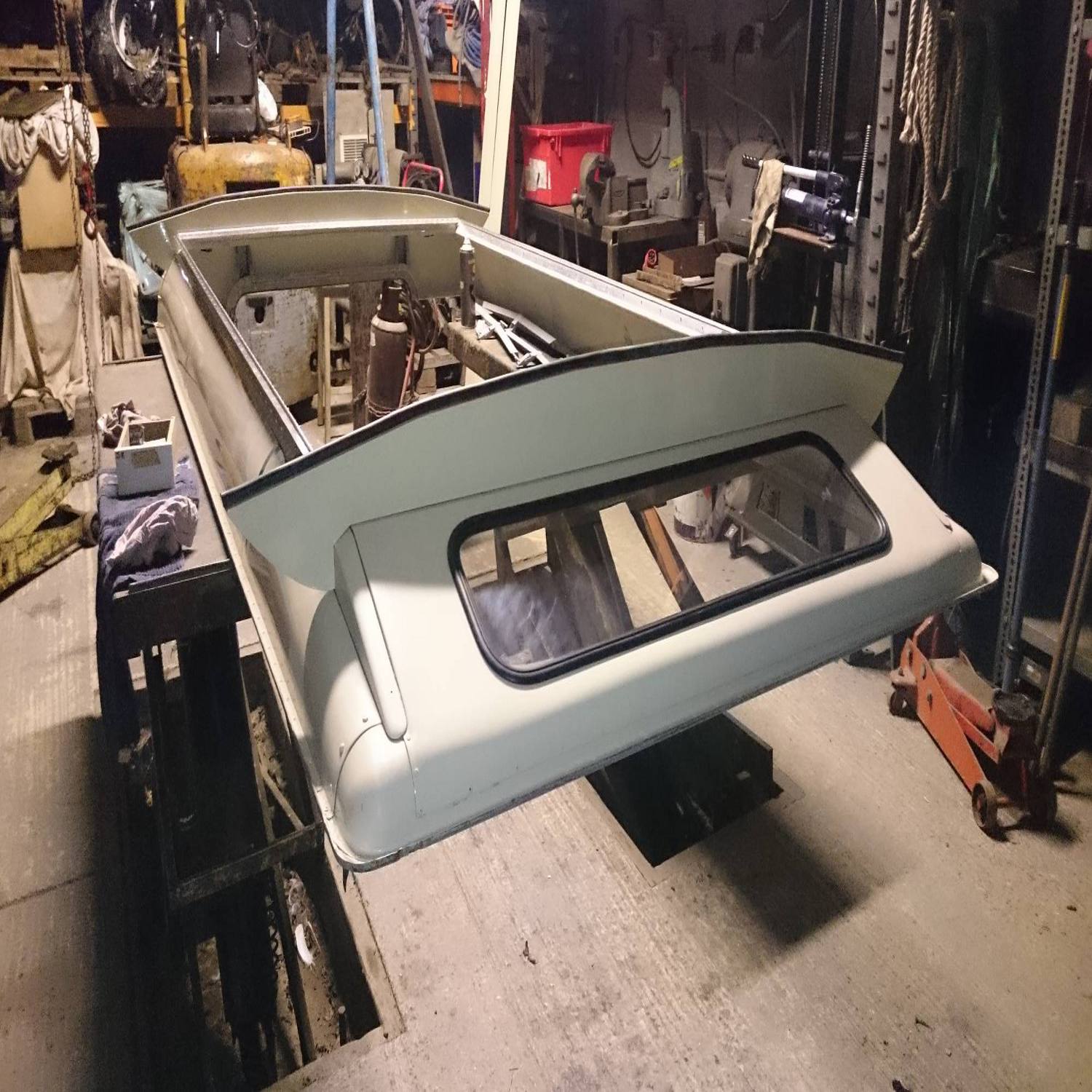

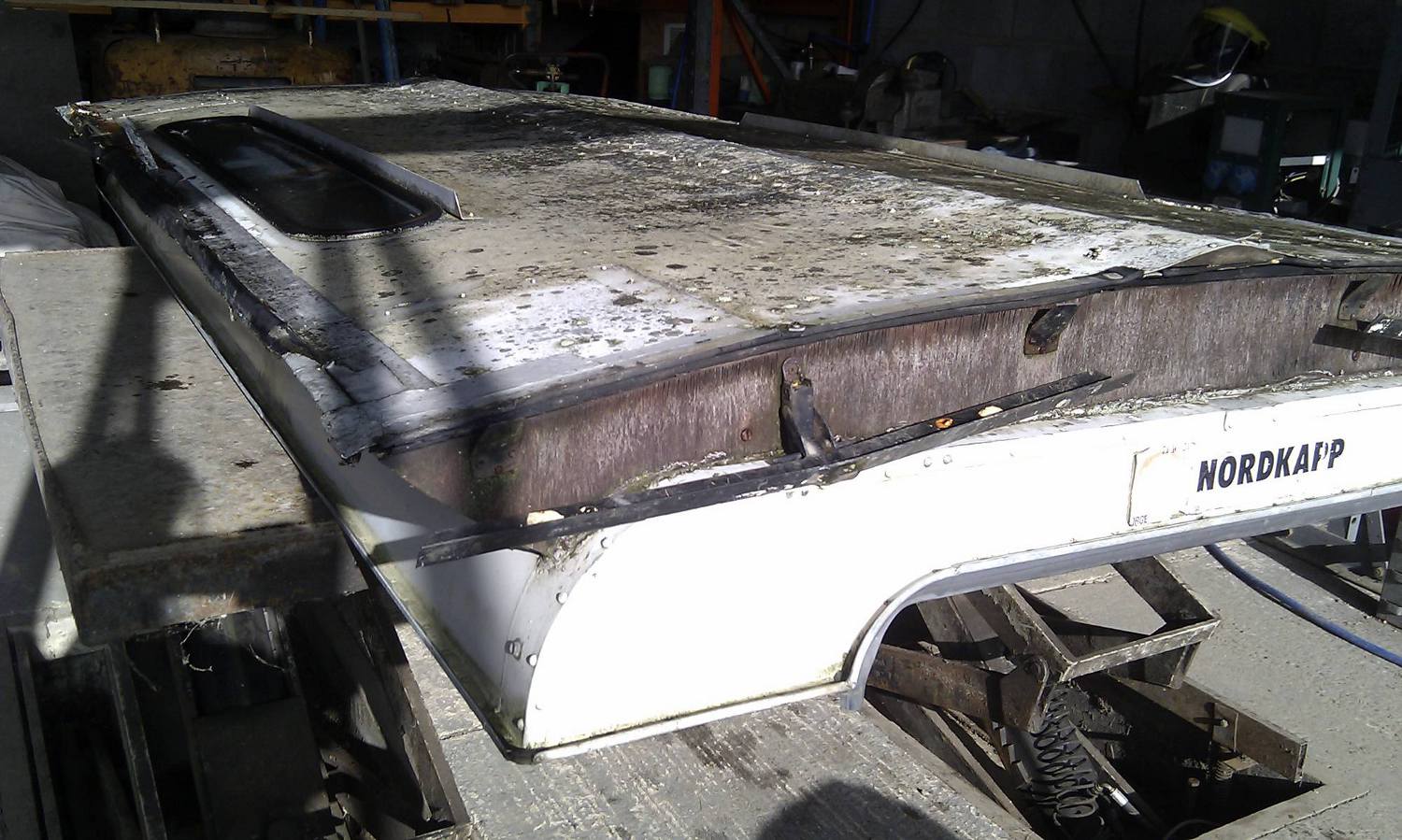

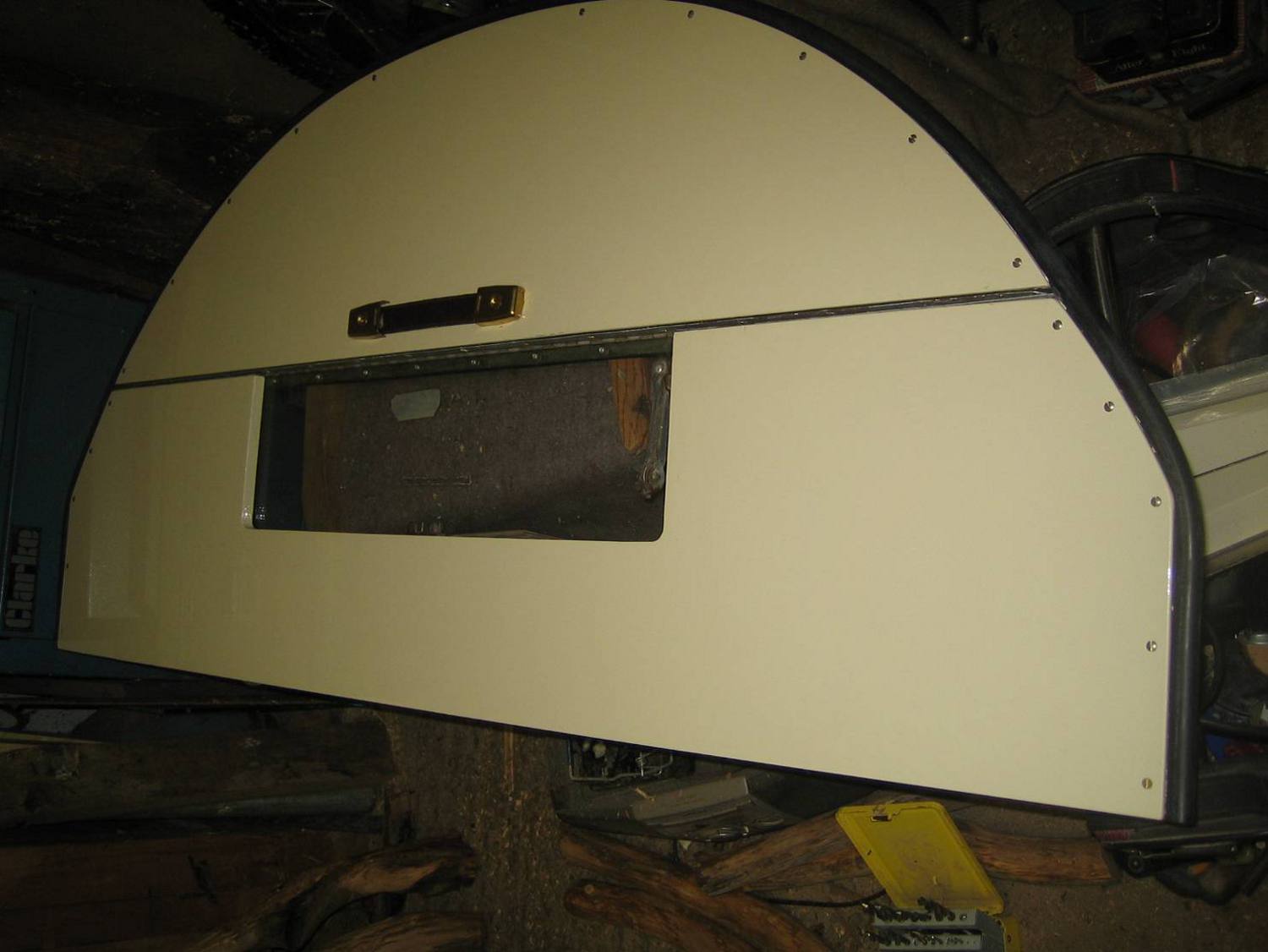

At last the carawagon roof is coming together, having made the decision to strip the old flock off it took a lot longer than I thought it would! The areas around the leaking alpine windows came off easily as did one or two damaged area in the middle, the rest was stuck very well.

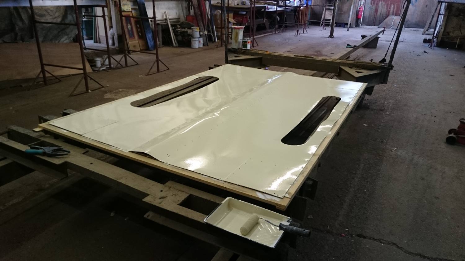

Then I had to strip the top side which had been gloss painted over the pre-finished ali. Of course the original finish bubbled with paintstripper and the whole lot had to be removed back to bare aluminium. I then re-painted using a roller to get a slightly textured finish.
I fitted the fillet pieces last night using grey arbomast br (we have used it for putting windows and skylights in boats) it doesn't set like sikaflex) seems to seal better than alot of other products. Terrible stuff to work with but once you squidged it out everywhere it cleans up very nicely with a rag and white spirits.

I took the roof off about 2 years ago, it has taken me far too long, too much work, not enough play.
I did take the carawagon (with a normal landy roof) to Oban last year and camped in it for one night on the way to catch a ferry, but have decided that it is time to get it all back together before the winter.

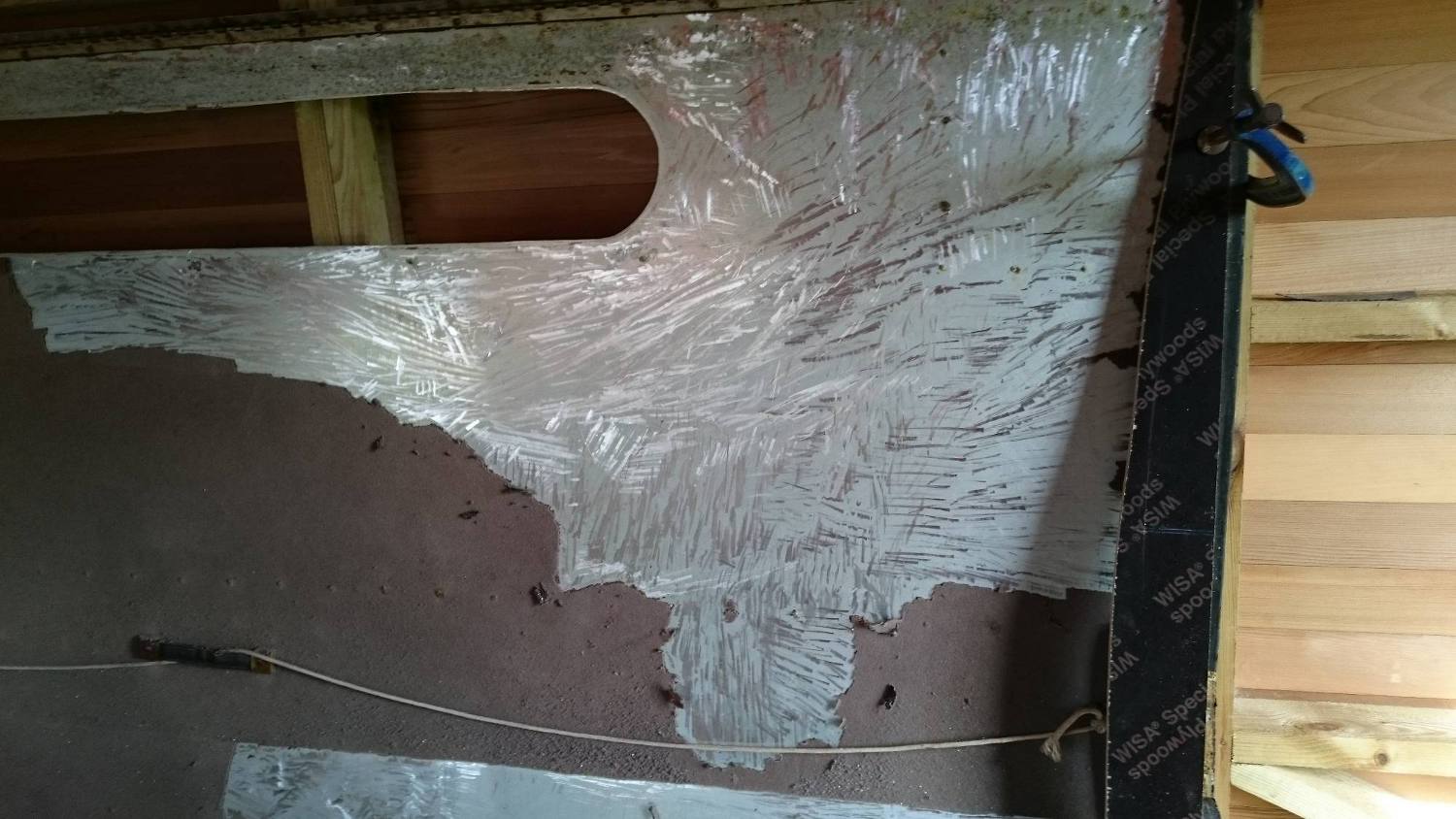

I spent a couple of days on and off carefully scraping the flocking off the flocking roof
using a very sharp bevel edged wood chisel being very careful not to dig in the corners or score the ali, the flock looked beige but when I removed the wooden blocks with the brass hinges on it is grey with a slight red fleck. I will ask the flockers on Wed. how they would have removed it.
I will let you know how I get on. I made a wooden frame to hold the bendy sheet and that has worked really well, I have been able to move it on my own without damaging it using the screw holes for the hinges to hold it all in place.

I am taking the roof to the flockers tomorrow so I will ask.
I initially clamped 2 pieces of wood to the ends of the roof to work on it but the clamps got in the way and it was not ideal.
The long pieces of the frame have halving joints on the ends and are made from thicker timber than the ends, that way they can be moved in or out to the right width then each joint has 3 screws to hold it square. The roof sits flat on the frame for painting the top surface (screws through the holes in the ali into the wood hold the roof in place) or the frame can be turned over and the roof then sits nicely on the other side of the frame for the flocking to be done, because of the different thickness between the long sides and endes of the frame it gives the offset for the thickness of the ridge.
