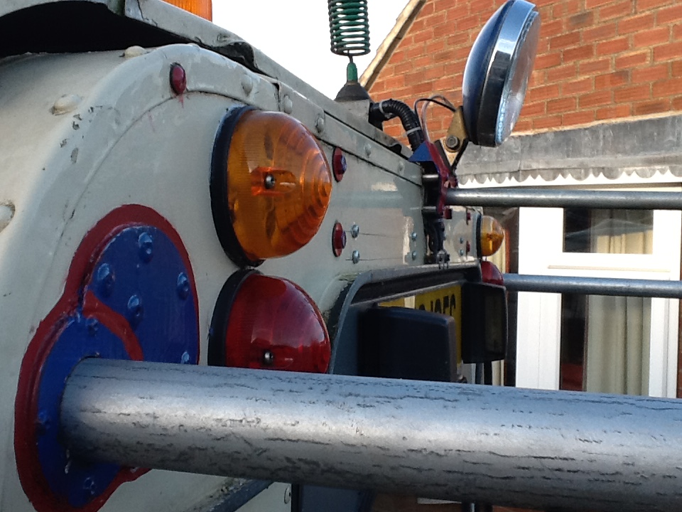

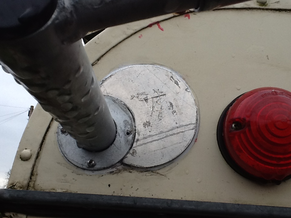

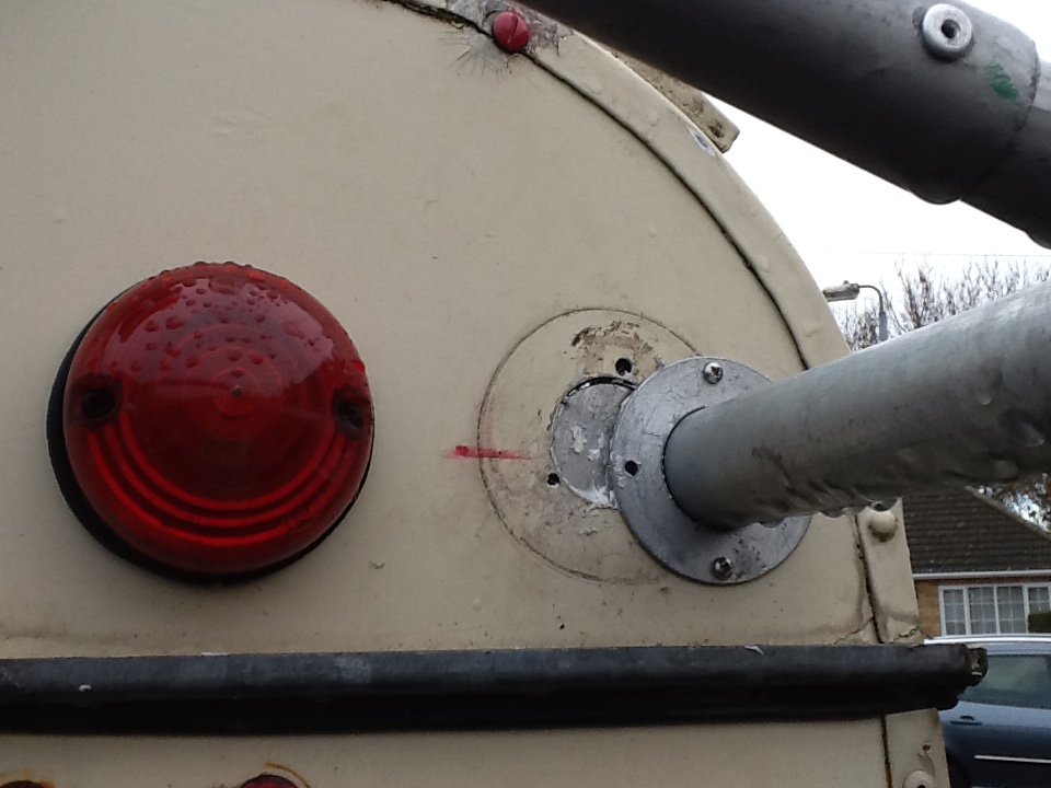

G'day chaps, having spent a good part of yesterday in my bed trying to warm the bottom part of my back to help with the discomfort of standing a lot the previous day it was back to tinkering with the making of two round alloy plates the size of a light fitting that Simon had to take off because it was in the way of the side poles of my new canopy.
Of course i have extra lights indicators and work light that were in the way and although Simon worked fast in a T shirt he was very careful and now i am making fillets for where the indicators on the top corner each side were mounted i then set to and made only one up till now semi circular plate that cover where the top indicator was situated.
I will be fitting everything back where it was prior to when the work was started but in a place that it does not interfere with my canopy basically because what was there was put there for a reason so why change it but then tinkering with angles and odd ball things is done because i enjoy doing something different :laugh: .

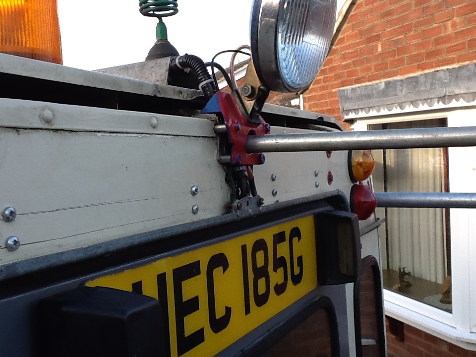

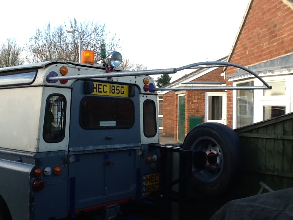

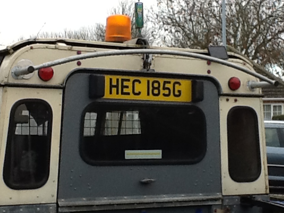

Here is the photos i have taken today, at last the rear canopy is fitted, not straight forward but then thats brad wanting his way.

G'day chaps, now back on my old faithful computer i can explain what was done and why but i guess it's easy to see that my top indicators have gone and what i have had to do to have the best of both worlds so to speak but fear not the indicators are just being fitted in a different place :whistle: .
The bracket that held my rear work light has had the center cut out so as to make provision for the center pole of the canopy so hopefully all being well tomorrow that will all go back on and i will be back to where i was before Simon started the job bless him :cheers: .
