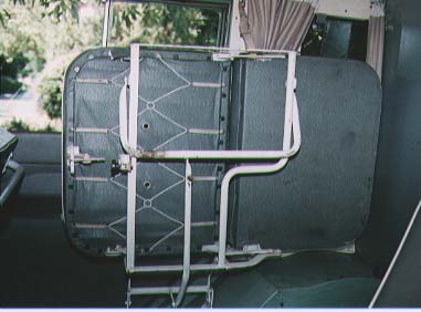

Post by jerryd » Fri Feb 19, 2016 11:12 am
Hi Glen and welcome to the forum, the rear seat straps were made of canvas and had a simple buckle on them . Mine were a bit worse for wear and I removed them and replaced them with a more modern plastic type as fitted to schoolbags :whistle:
I think I might have kept the originals, so when I remember I'll try and find them and take a pic. This pic shows the strap (at the front of the curtain )

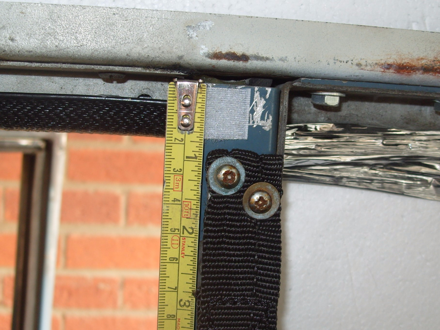

Thanks all! Can anyone post a picture of the straps installed please?

Post by Dormy » Tue Mar 08, 2016 5:54 pm
Hi Glen,
Here is a picture of where they attach on the 'C' post, (interior trim not currently fitted). Note; the webbing on mine is a replacement as the originals finally split after many years and the black nylon strap was just a convenient substitute. I still have the originals - somewhere ?
