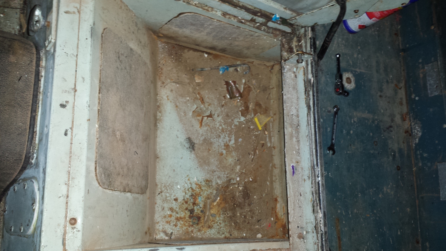

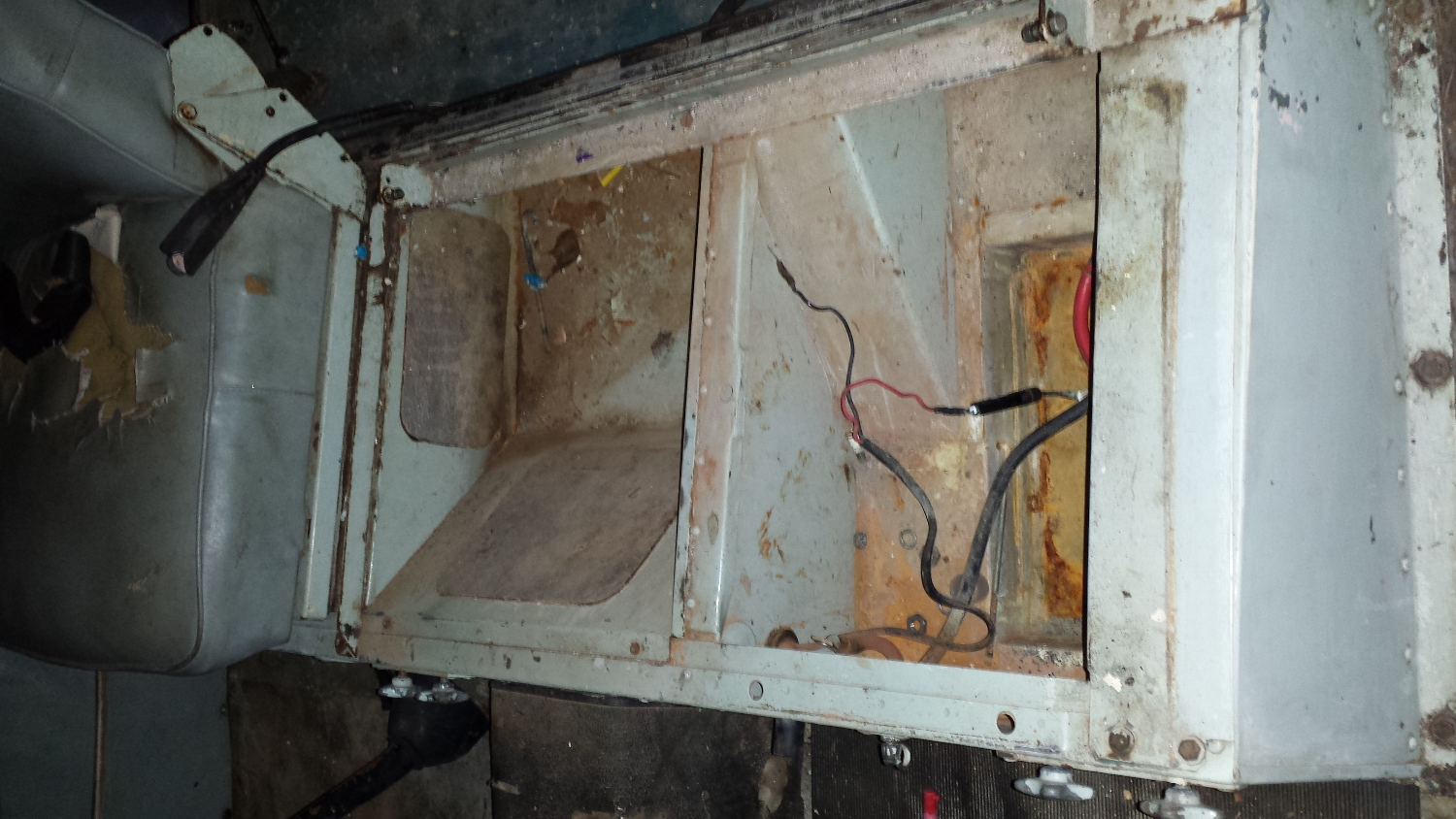

G'day all. I'm in the process of dismantling my Dormobile and I need some advice on what's original Dormobile fitment and what's been added by previous owners

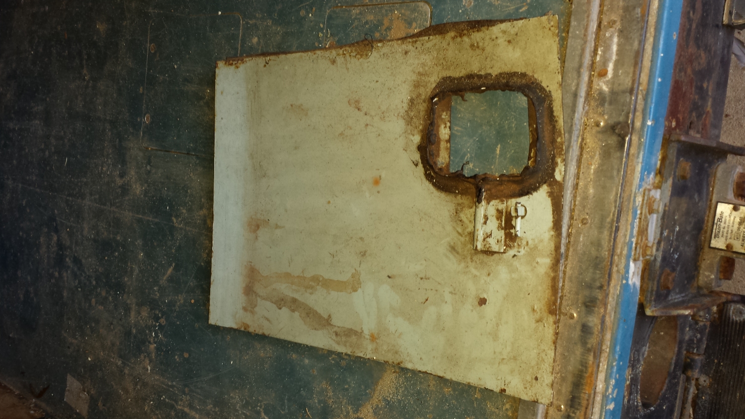

Firstly the toolbox (?) directly aft of the transmission tunnel under the passenger's seat: And under the driver's seat. Is this the standard panel for access to the gas bottles? Many more questions to come.

Yes, both are standard

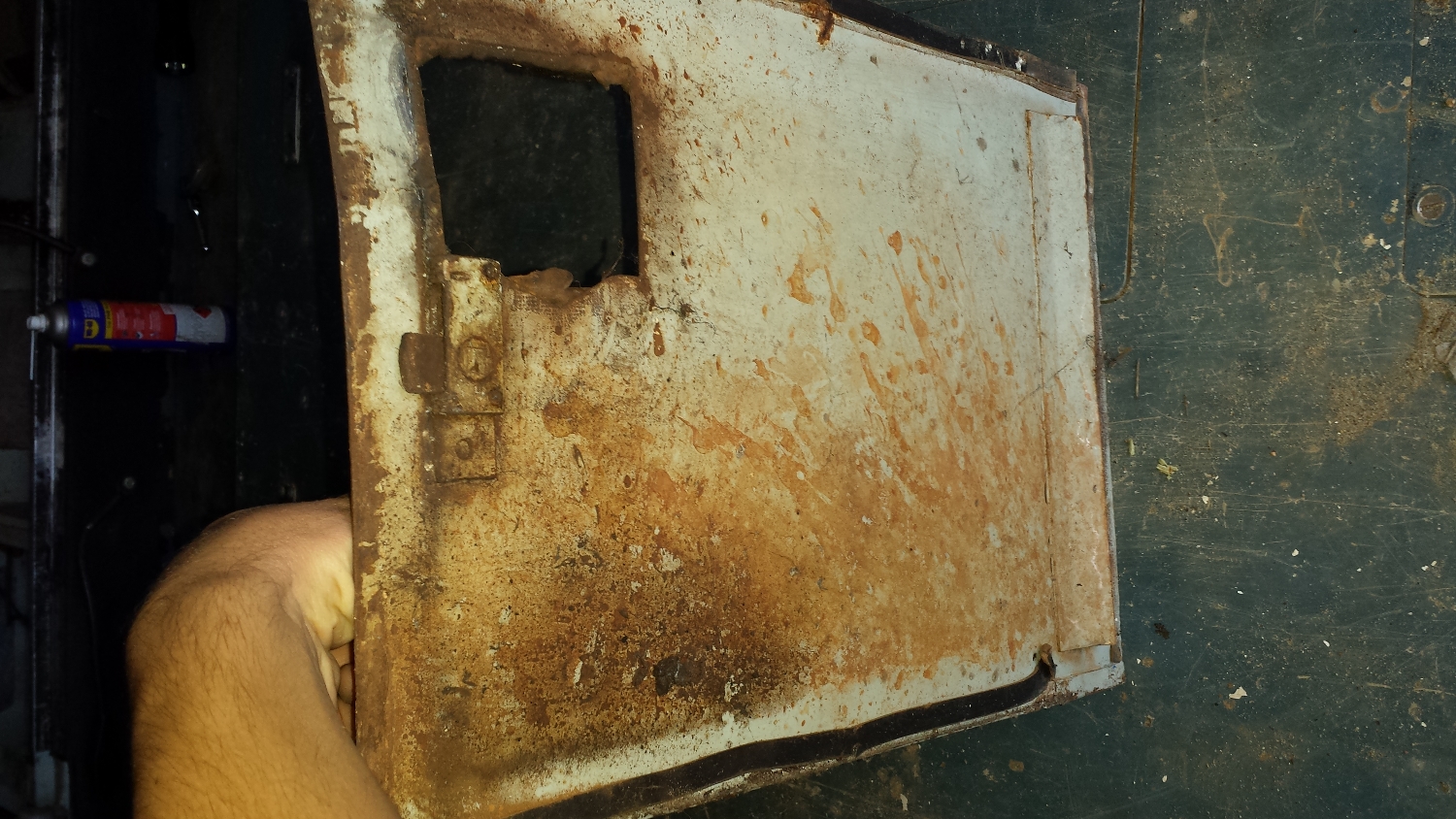

The crude hole in the gas-bottle access panel is obviously a PO's attempt to get to the valve on the bottle without removing the panel. Having to remove the drivers seat completely to turn the gas on/off is a bit of a pain.

Thank you Ian yet again . The panel is steel is that standard also?
And I can't see any straight forward way of removing the driver's seat, without undoing the 15,000 bolts and screws holding the frame in. Am I missing something?

Oh and further to that, the hole in the panel was for access to the under seat aux fuel tank. Not the best job I've seen but definitely not the worst!

Mine has a hinged flap in the side of the seat box to access the gas bottles. Quite a nice PO modification.
It also has a larger tool box, but this is on an early 62 (?) seat box I am using for my current rebuild. None of my other Dormobiles have had the big tool box

Thanks everyone. I had a win tonight. Finally got the seat removed (it slid surprisingly easily on the runners) but not before I had to remove the s3 hand brake lever that was stopping the seat from going all the way forward!
The centre toolbox is retained by 2 screws along the front edge and a lip around the periphery. It's not sealed along the back edge and is open to along dust/dirt to enter the vehicle. Is that normal?
