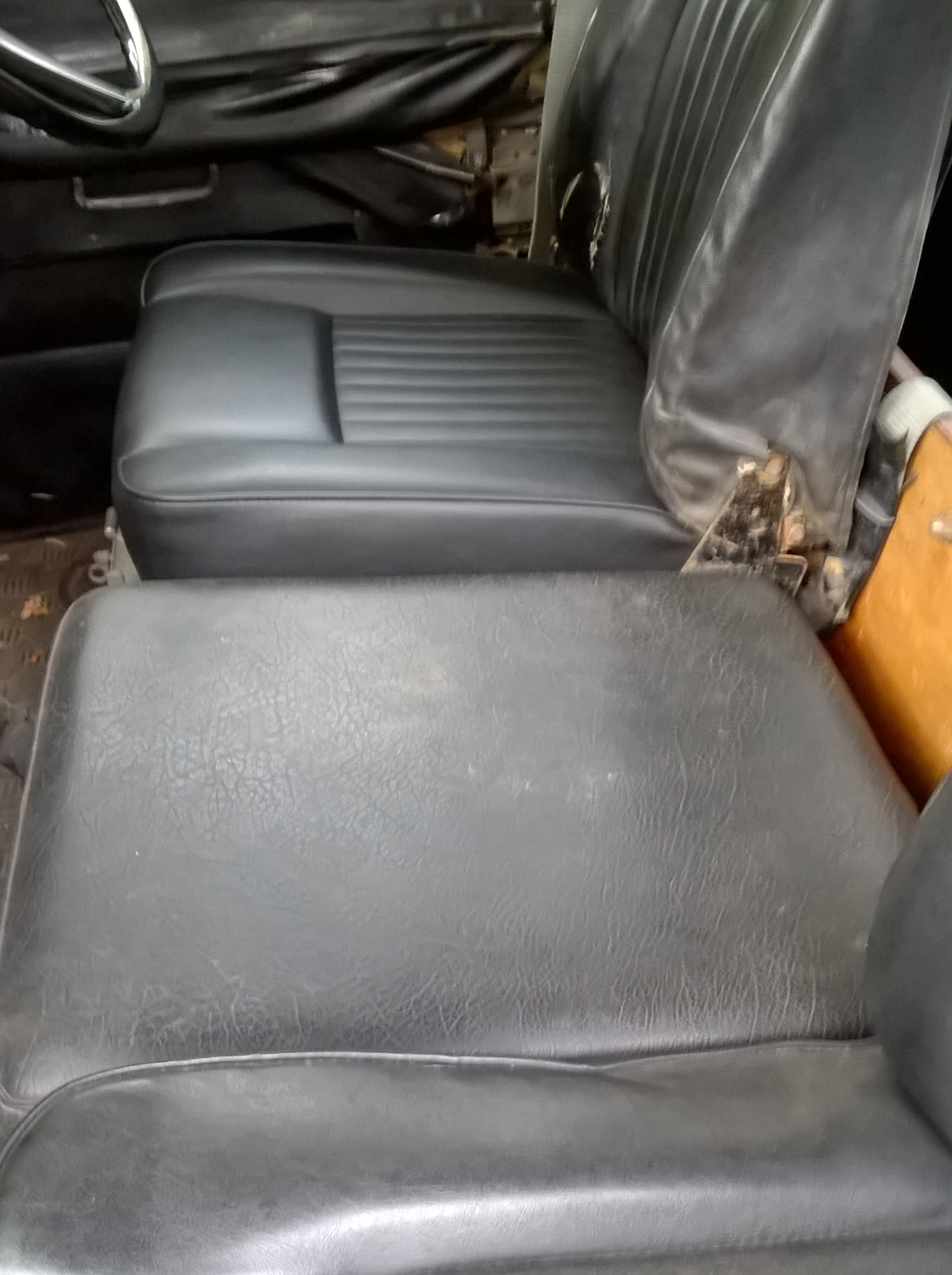

I’m wondering if anyone can give me some advice about putting my bed together in my Series 3 Carawagon Continental?
Using photos from old brochures I can get the rear section put together fairly easily and if I fold the back of the driver’s seat down the base cushion from it seems to fit fairly well on top of that; so far so good. The centre section however is another matter – currently the cushion is too low:

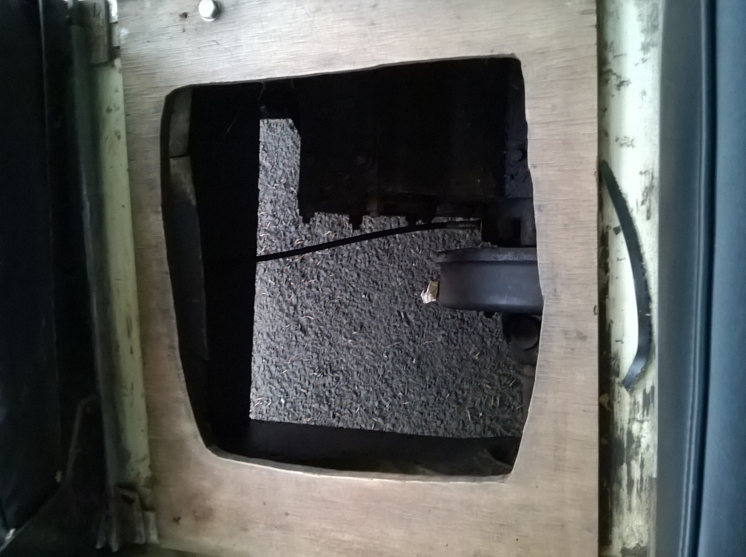

While I’m on there’s currently a gaping hole under the centre cushion with a wooden surround; I’ve found tool tray’s available online which are designed to sit in the centre but looking at the rather homemade style of the frame I’m guessing something else went in there – anyone have anything similar in there’s?

Yes, you are missing a wooden cubby box which would bring the seat cushion up to the correct height.
The cubby box was an option, as was a porta-potti which would fit in the cubby box = I wonder if the hole underneath was for something like that?
It should be easy to make a wooden cubby box, I would think :shrug:
Patrick's Continental still has the centre seat, with a tool tray underneath, which folds the same as the driver's seat for the bed.

Hi Robin – thanks very much for that, that strange shaped hole makes sense at last :bow: I've looked up some vintage porta-pottis on the internet and the way they are shaped on the base looks like they would slot right into that gap
To be honest though I think with the height that I am I'd struggle to 'use' that space so may just convert it back into a centre seat with tool tray underneath (making a cubby box would require some DIY skills far beyond mine :embarassed: )
