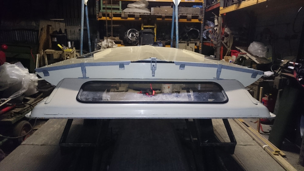

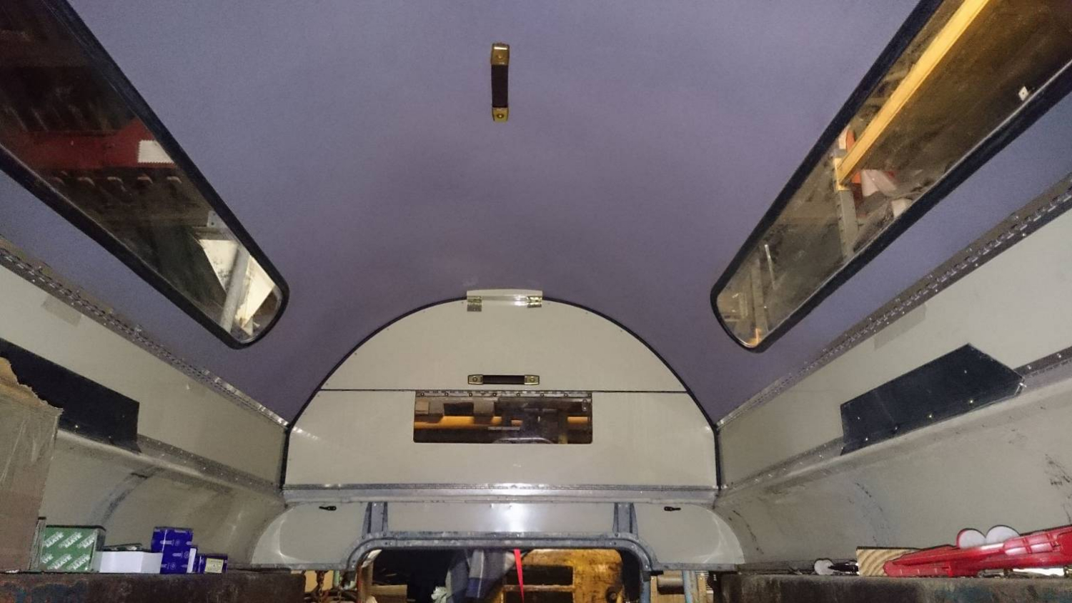

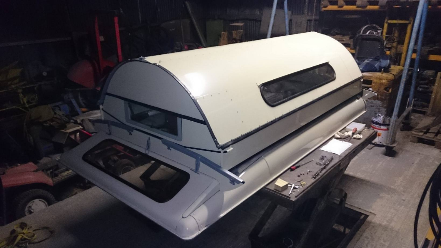

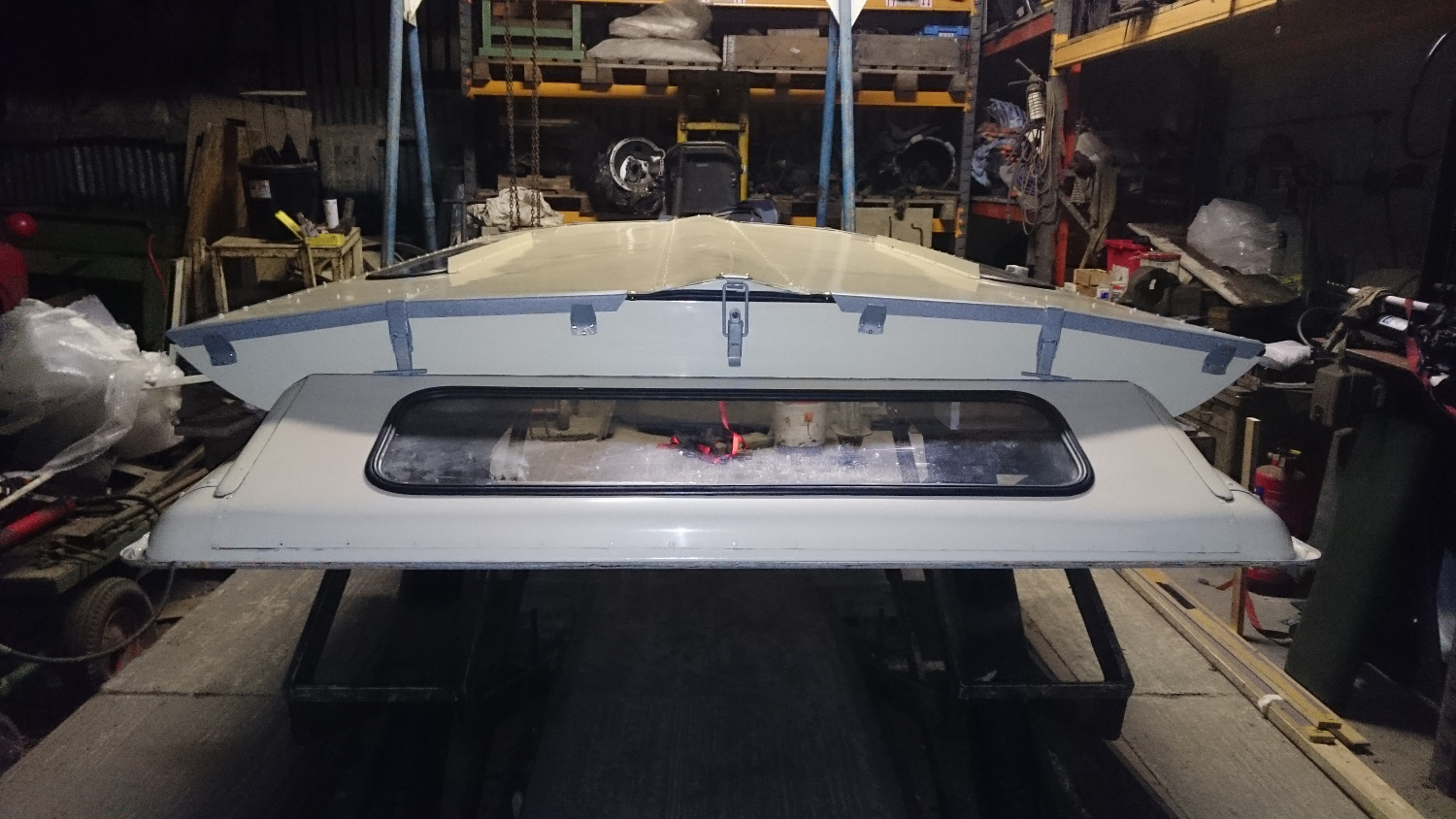

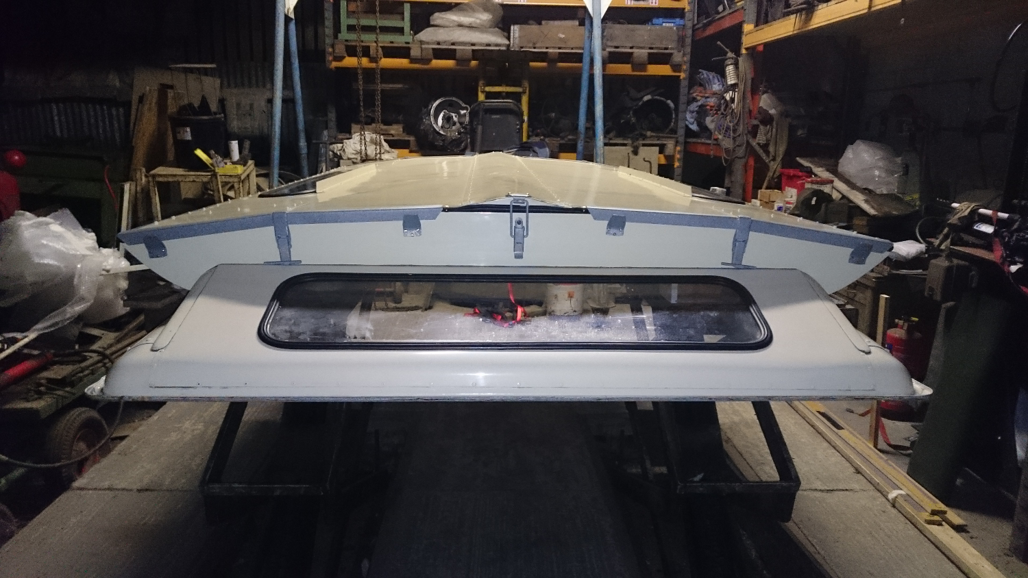

Here are one or two photos, I have sketches and more photos of the restoration if you need more info
Regards Christine
pull handle on cream end to fold down
roof up
roof up
roof down
roof down
