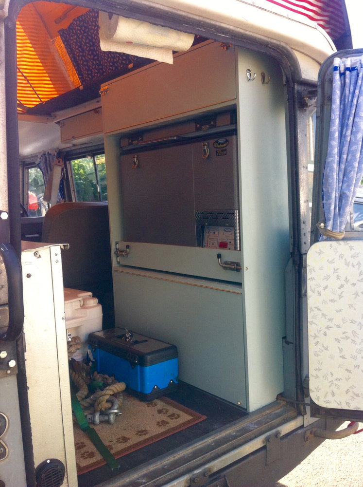

Hmm, as much as I love the idea of travelling in an original vehicle, those wardrobes aren't the most useful things. We use it for storing things that could be stored in any old box anywhere. I could store it in the garage at home and replace with somethign more useful.
I like the additional shelving you have around the fridge, Michiel, and the hooks. Where do you store water, now?
