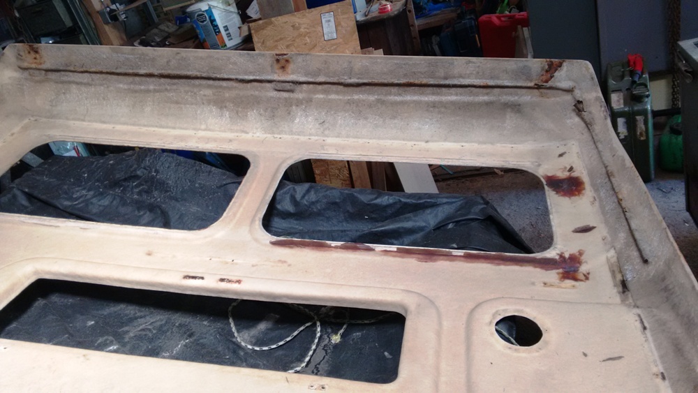

I've stripped my Dormobile roof to repair a couple of slightly damaged areas, and see that there is a steel tube fibreglassed in along the hinge side and halfway across the front.
The quality of the fibreglassing over the tubes doesn't look very professional and actually has open weave sections where not enough mat was used and which has allowed water to get to the tube and rust it through :thud: I wondered if these were standard or if someone has added them to this roof at some time.
The tubes have rusted through in places and I can't see them doing much strengthening in the state they are in.
I intend cutting them out and replacing anyway, but I just wondered if they were original :shrug:
It also looks like there were steel plates glassed in where the hinges mount, but these have also turned to dust so I'll be replacing those as well - again, I assume these were original?
By the way, the red/brown patches shown in this picture are from a previous owner repair and looks like it was used to try to stick the curtain rail on one side.

Don't think there's anything like that on mine. Easiest way to find out is to look at the Dormobile parts catalogue (sit down for the prices!) as you can buy everything new.

I did look at the parts catalogue, but I would think that if the bars are original they would be incorporated in the roof shell and not available separately.
Of course, the roof moulding could have changed over the years, or, as I suspect, this is a previous owner modification to give a bit more rigidity :shrug:
There are a couple of other members on here who have handled roofs off vehicles recently (Simon & JohnH), so I'm looking for a consensus, I hope.

I am pretty sure that they are original. There definitely are plates at the back of the hinges (which rust)
If in doubt, give Steve at Dormobile uk a ring - He should be able to confirm

What is the small round hole for ?
Very brave, taking the complete roof apart They are a pig to get back together, esp the "canvas" re-attached to the hinge side of the roof

The hole is a vent - there were two as you can see here:
I'm not sure whether to put them back on or to fill the holes while I've got the resin and mat on the go.
I'll be following your example, Alex, and spraying the outside with white paintable underseal to cover any blemishes and crazing in the gel coat (and the round holes if I decide to fill them!
