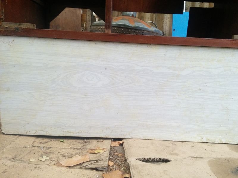

With nowhere to go and no prospect of adventuring in the next few months I decided to remake some of the butchered Carawagon furniture the previous owner had a go at with a nail gun, red laminate and glue.
In pulling apart the side cabinet I found that they had stuck the reddish laminate over the top of what may be the original. A white wood grain pattern, the photo is one of the kick boards, about 10 inches tall.
Original laminate?
Original laminate?
holly original laminate.jpg (64.85 KiB) Viewed 42102 times
First question, is this the same as other Carawagons?
I remember they are usually white with a grey pattern, but I don't recall such a distinct wood grain. I think it's totally smooth but being covered in adhesive it's hard to tell for sure.
Second question, does anybody have a source for a modern equivalent to it?
Thanks,

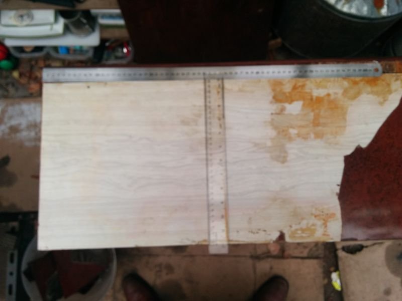

But today I've actually managed to peel off some more of the red laminate and the surface underneath isn't that bad. Unless there's some horrors lurking under the bits I haven't got to yet, I don't really understand why it was covered over in the first place.
After trying various solvents and thinners on the adhesive residue, I found WD40 specialist degreaser dissolves it really well so I am optimistic about being able to salvage the rest, in the blurry photo just that first square has been quickly wiped over with it.

My new plan is to try and build something vaguely similar to what I think the original was but to suit my requirements, and if I can then I'll reuse the white wood laminate panels.

Thanks Phil, that's exactly what I needed to confirm that it's the original surface.
I'm still planning to reuse the worktop, but as I uncover and clean more of it I'm finding there are bits of damage here and there. So I've ordered a roll of stick on vinyl with a similar pattern to stick over the top. That way if a future owner (or me) wants to go back to the original or do something different then it'll be a simple matter of peeling it off. Time will tell how well it lasts, and if it looks anything like the original.

Patrick,
I believe the original material was “Formica” which is still available today.
They make a wide range of colours and can supply swatches. Hope this is of some help.
Andy
Re: Carawagon laminate - all the same, and modern equivalent?
Posted: Sun Jul 05, 2020 12:04 pm
by Calum
Just been cutting an original piece of Formica in the Carawagon yesterday - the cooker lid is now hinged a little further forwards so I can open it fully under the roof. It also allows a vent at the back for the fridge below. My Formica is a different pattern but as my cupboards were built by the first owners I am not entirely surprised. It's incredibly hardwearing stuff given how brittle it can be on its own. On my long cupboard I have some rust stains from a couple of items that were sat there whilst it was sat parked up for 20 years. I have managed to lessen their appearance but not remove them altogether.
From all the original vehicles I have seen the pattern on your laminate looks to be correct.
