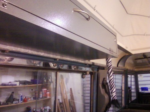

I added an extra cupboard in front of the spice rack. It was a pain to build due to the curvature of the roof. :banghead:
If you are making one, make the vertical pieces first and then add the horizontals. The spice rack has sliding perspex doors that are held closed by a knob that screws into the metal and through the doors.

Looks good Ian :cheers: Is that a timber trim you've fitted to replace the plastic item ?? Do passengers bump their head on the extended unit ??

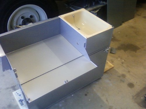

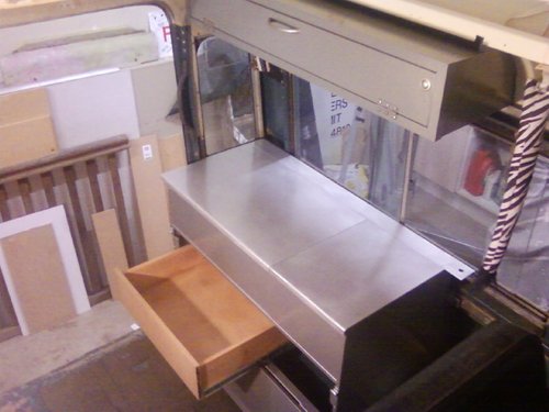

I made a deeper version of the spice rack cupboard so that it can hold a full dinner set, I've just refurbished my original kitchen unit too. I had it sandblasted and have painted it to match my other remade furniture,I also made some heavy duty lids that one can stand on to hop into the bunks. I've also been playing around with the inside of the unit and have made a slide out drawer unit. I thought this might be an easier way to stack items. Underneath the drawer unit is the water pump, the external hot/cold shower unit and a space for a compressor.
The drawer unit is fixed to a cover which is held in place by four screws, so access is easily available. I'm just about to plumb in the water which could be fun :cheers:

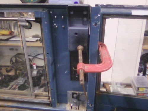

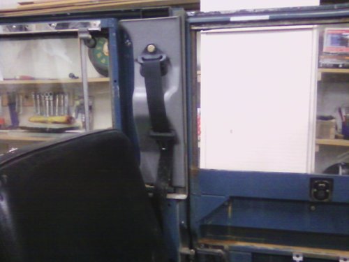

Post by jerryd » Thu Mar 06, 2014 1:15 pm
Hi Michiel,
I've kept the defender rear seat belts in mine as in the first and second pics, the actual seat belt assembly is fixed to that black metal plate and is covered by that grey plastic trim.
My original rear seat belts were just bolted to the rear wheel arch with a metal plate sandwiched between floor -washer - nut, so maybe that's how the Exmoor Trim ones work also :shrug:
