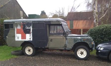

I purchased "Mummy Pig" in 2010 and went to work sorting out the chassis and bulkhead just to get through the MOT which she did with suprising ease considering she had sat for at least 10 years prior to sale apparently! I purchased her from Pa Blanchards.
I drove her like this with the original engine which ran beautifully but only managed about 13mpg with a top speed of 50mph (ish). Being overtaken by lorries on the moterway and hoping we would get to the top of a steep hills made my mind up and I went for the 200TDI conversion.

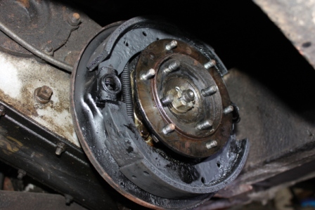

I also had a little problem of forgetting to take the handbrake off fully nearly resulting in burning the whole thing to the ground!
landy strip down 022.jpg (93.27 KiB) Viewed 20309 times
oops, fortunately it was snowing at the time, so pleanty of coolant on hand....

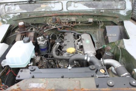

Now I would have loved to do the convesion myself but due to my limited experience for such a big job and lack of time I had a superb chap do the conversion for me and what a top job he did! she now does about 24mpg and cruses at 65 which is pretty good considering her weight! I also had in mind when deciding to have this job done for me the safty of me having a go over the professional job as I would be dragging my young children with me on camping trips.
Job done!

When you upgraded to the 200TDI, did you change anything in the transmision or did you stay with the original gearbox/transfer case/rear axle?

HI Ian,
I have uprated the diffs to 3.54 from a range rover but everything else is standard. I would probably add a 5 speed box one day rather than an overdrive but to be honest I don't really think it needs one, I just have to careful not to go crazy and rev the nuts out of her..
Regards,
Mark
