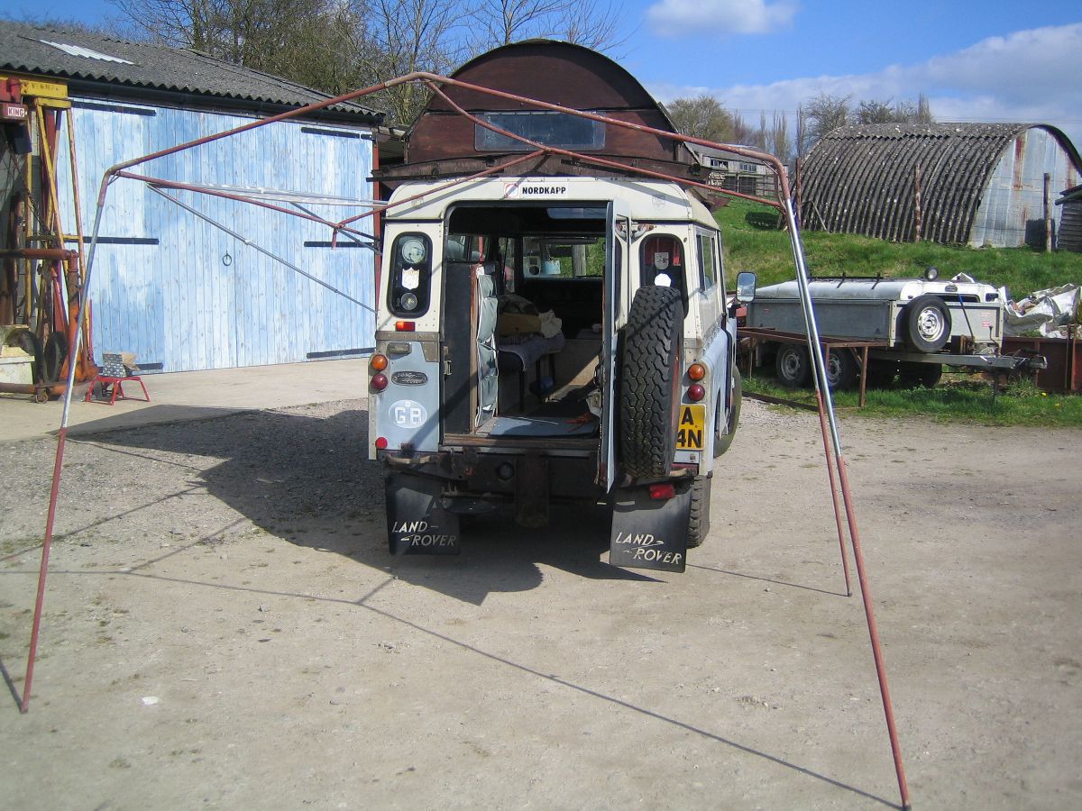

Free standing tent poles

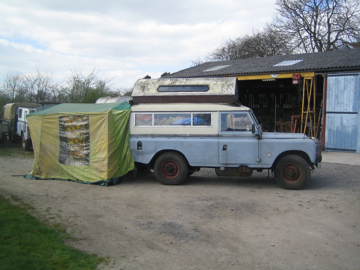

This is the free standing tent that was with my carawagon when I bought it. It does not have the pull out awning poles but has free standing poles with a couple of poppers on the roof that the tent fixes to.
Free standing tent
Free standing tent

Thanks for those pics, that is exactly what I received with my vehicle too. I'll try again at the weekend to assemble the frame..........the tent is identical !

We assemble the roof section 1st then lift the whole lot to put the corner poles in, not a one person job.
I have another carawagon body and roof that has the pull out poles but no tent to go with that one, probably a better design as you don't need to carry the bulky poles inside the vehicle. Eventually I would like to get a tent made, I noticed in an earlier thread someone on here had one made (very nice it was too.) I was quoted £700 to £1500 it will have to wait a while. Any recommendations?

Success ! Thank you both.......Christine, the pic of the framework will help a lot. It looks to me like I may even have too many poles :stars: maybe the original owner took spares for their epic trip.
