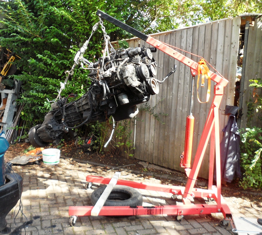

Well, after languishing on my trailer for a few months, I decided it was time to start stripping a Disco 300TDi.
The engine will be put into my 1972 Carawagon project, along with an LT77 Defender gearbox - it's a 6 pot chassis so it should fit ok with a few mount and propshaft mods.
Alex has done the same transplant (or was it a 200TDi?) in his latest Dormobile so I'm hoping he'll be available for tips :wink:
Here's the engine & box removed from the Disco (this box will be sold on):

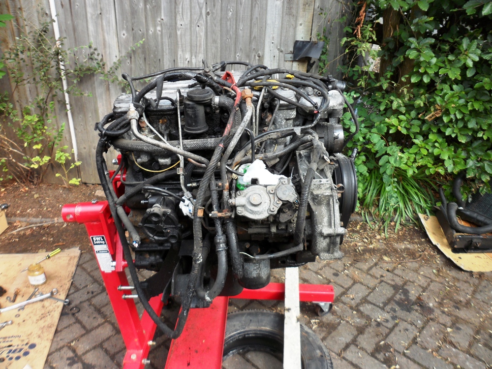

and the engine on a stand, waiting for a clean:
More later as it progresses :cheers:
