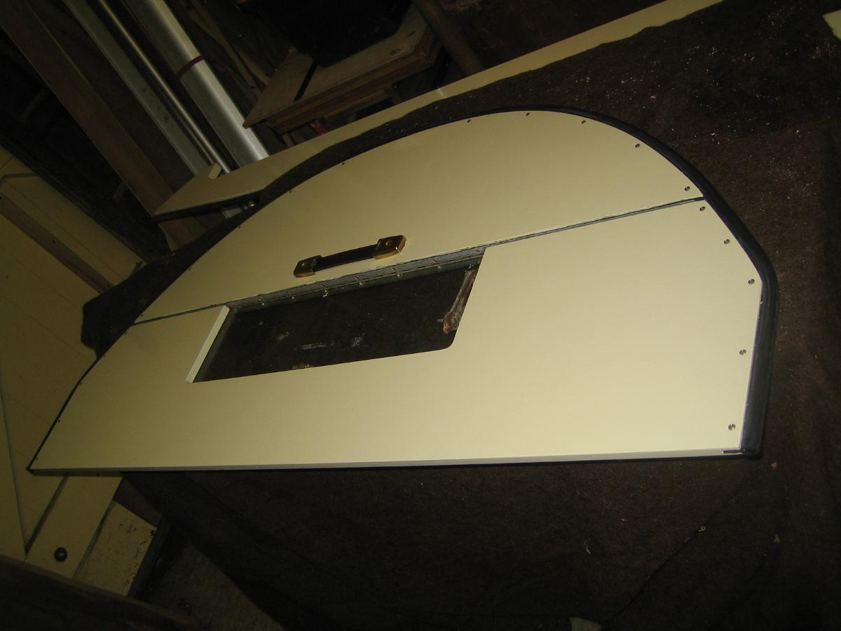

My carawagon roof restoration is starting to come together.
It has just passed another MOT thanks to my OH rebuilding the front swivel and new servo. I need to sort out the bendy roof section next, dirt and flaking paint on the outside, damaged flock on the inside where the windows have leaked.
The main aluminium roof section is all painted, next job with that is to start drilling holes in the new hinges to match the pre-drilled aluminium angle.
Fit wooden fillets (all painted) where the wooden roof rack would have gone (I have a galvanised roof rack which I will only fit when I need it) It has a skylight fitted from new, the two sisters who first bought the carawagon were keen bird watchers so they had a perspex window fitted. The two sections that support the aluminium sheet when it is down are also ready to fit. Just need a day when it is not too cold outside for the sealant to go off and my fingers not to freeze.

Looking good Christine - hope you get it finished in time for this year's round of events :cheers:
I found the most accurate way to do the holes in the hinge was to drill an end one and use a small nut & bolt to bolt it to the roof section.
Then drill one a couple of foot along using the existing hole as a guide and fit another nut/bolt and so on to the other end, then once it is firmly fixed, go back and drill the rest.
I suppose you could use clamps/mole grips to hold the hinge in place and drill, but just keep on going back to check the hinge hasn't moved.
Have fun - I've still got another two roofs to replace on my projects - got all the wood cut and the seals. Like you, just waiting for some warmer weather to get them done :cheers:

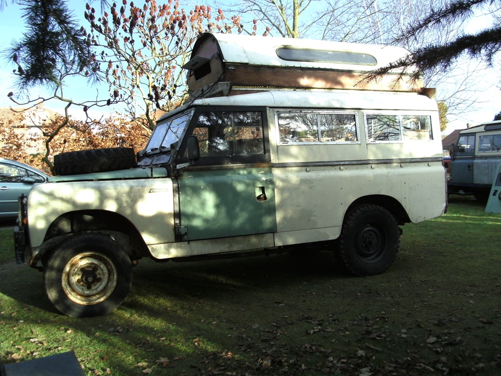

We already had Patrick's Station Wagon Carawagon
which we restored for a Morocco trip, then I got my first one (the one I'm using now) shortly after that.
That one I restored in just 3 weeks as Patrick was going on holiday with his and I needed one for our first show stand at Driffield! So that meant swapping the engine for a 200TDi, replacing the roof woodwork and seals, and painting some panels - finished painting some weeks later.
Two others came up on ebay - there were no bids on them after a few days so I approached the sellers with offers which they accepted :nana1:

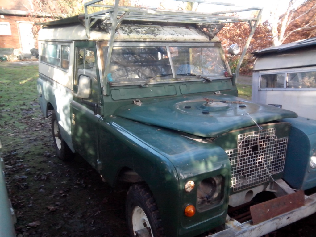

One is a complete Carawagon body, lifted off a dead chassis but all complete. I went all the way to Truro for that one, with a trailer I made from scaffold poles just for that trip!
I also bought a 1958 LWB project for that body to drop on to, though that also needs a new chassis (galv chassis waiting in my garage).

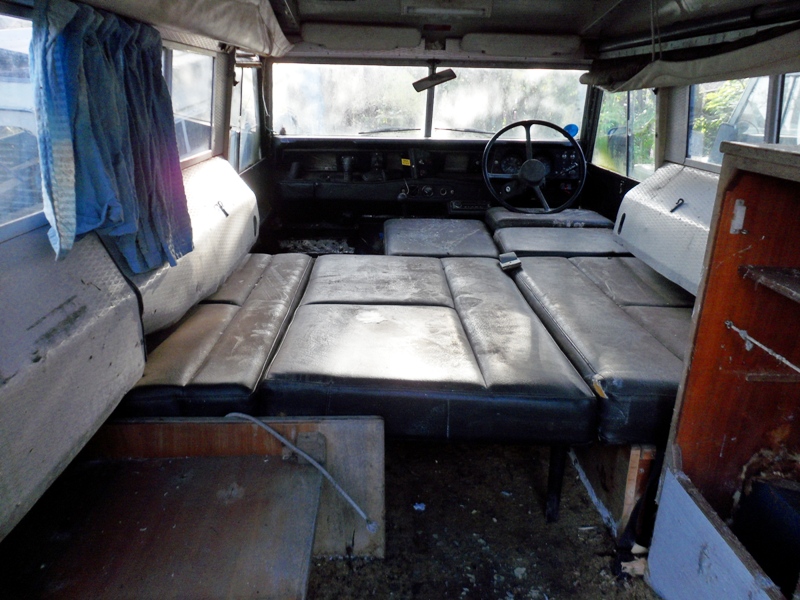

The other is a 1971 S3 with an unusual bed arrangement; 2 singles or a double across the whole width of the vehicle.
That came on a galvanised chassis about 5 years old, but no engine or gearbox and nothing bolted together!

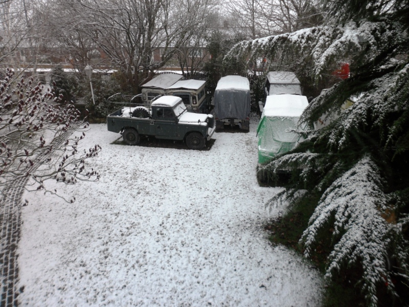

Luckily we have plenty of room to store the projects :whistle:
My intention is to restore the two projects, then sell one of the 'standard' Carawagons, leaving us with Patrick's SW Carawagon, the one with the double bed and one 'standard' one (1958 so MOT exempt :wink: ) so all different :cheers:

The two singles is pushing it slightly, I'll be using the bulkhead as a pillow on mine! It looks to be the same layout as the S3.
