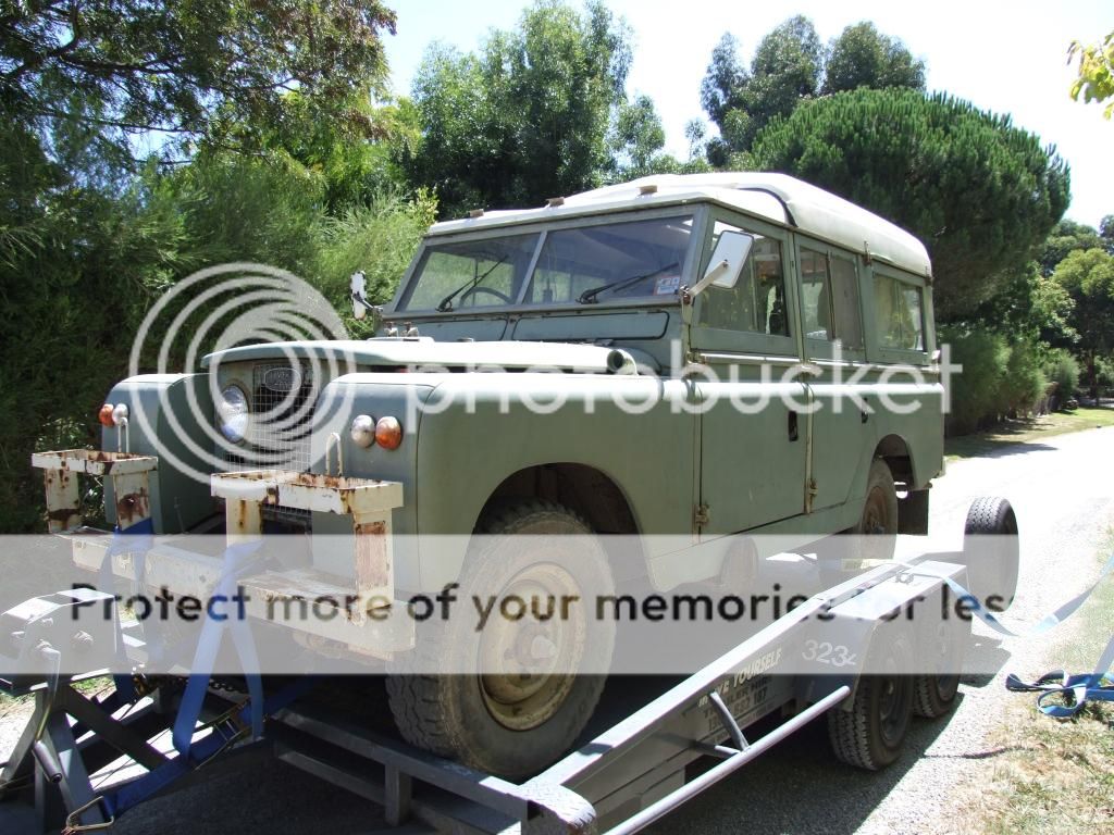

On the plus side there is no rot that I can find and it starts & drives OK (apart from a blown silencer). Engine & gearbox have been rebuilt in recent years. Could almost have driven it home except it was on the New South Wales border about 4.5 hours from home so I trailered it.

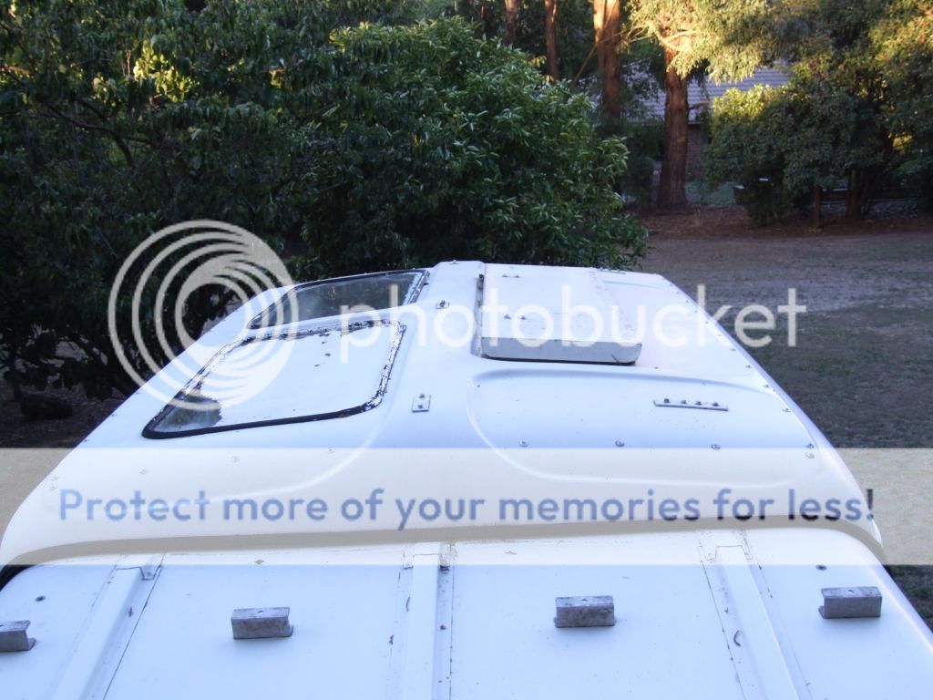

The stove is missing part of the grill, the gas jet is there but there must be a diffuser that plugs over it which has got lost.
I also noticed the roof hatch looks 'home made'. I guess the original got damaged and they had to fix it somehow so a home made job it was. The roof windows have been painted white, probably due to the heat buildup outback.
Behind the blanked off rear window is some crude insulation, again maybe to keep heat out ?

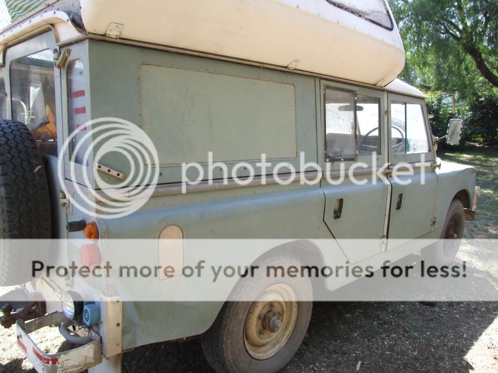

Back on topic - does anyone have ideas as to what the 4 holes are on the third picture down, above the rear tub (galv cappings) & below the rear windows (not the rear passenger second row doors) please?
My vehicle has the same & it has puzzled & vexed me somewhat as to what they are for.

Marque wrote: Back on topic - does anyone have ideas as to what the 4 holes are on the third picture down, above the rear tub (galv cappings) & below the rear windows (not the rear passenger second row doors) please?
If they are the ones I think you mean, they are the drain holes for the sliding window channel. As water can run inside the channel, it gets funnelled though to the outside world again via those 4 holes.
If you look closely (assuming the bottom channel is still there), you should see there is a stub of a metal pipe emerging through each hole?
Hope that helps,
I concuer with Patrick. They are the drain holes for the window channel. Although I have a suspicious feeling that in your Aussie climate they are not realy needed, but all station wagen have them.
If they get blocked in the uk for instance, you can grow your very own mobile garden... :laugh:

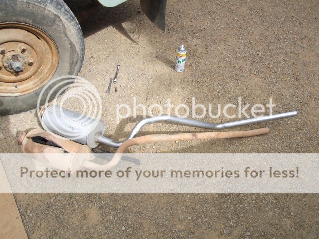

Fitted a new rear silencer/tailpipe. Mine is a suffix C chassis and it seems there was a silencer/tailpipe for suffix A & B and a different one for C.
Could only get the suffix C locally but I noticed on Walter that there was a hole in the mudflap but the tailpipe currently exited to the side. So the silender/tailpipe had been replaced in the past and was different.
Removed the old one and here they are side by side.
The replacement fitted neatly back through the hole in the mudflap !
Prices for Land Rover parts (even Britpart/Bearmach) over here can get expensive so I often purchase direct from the UK. The silencer/tailpipe cost $77 locally and was NOS. Much cheaper in the UK but I dread to think what shipping would have cost.....

P.S. Do you have whatever it is that fits to the brackets on top of the cab roof, if so any pics ?
