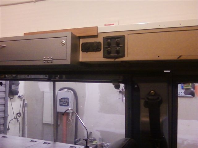

Here are some pictures. We tested the dormobile for the first time for a few days. I had built in the heater that performed really well. I had also built some new overhead cabinets in Dora. The original spice rack I had taken out and replaced with a much wider version of wood after the model of Jerry in Australia. I also made 2 more of the same size as the original to be positioned above the second row doors.

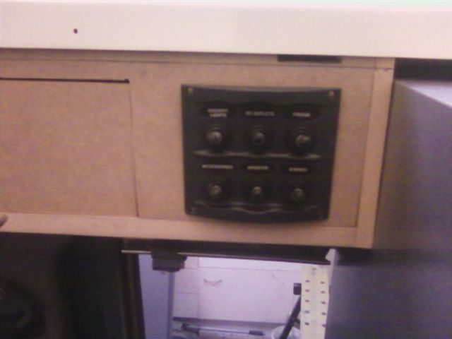

On the cabinets I made I put a 20mm aluminium angle around the face of the cupboard, this was to stop them "drooping" with age. It also gives a stronger fixing for the hinges to be fixed through the aluminium. Something you might want to consider.
I find the defender seatbelts work great and are a great improvement, but shutting the curtains can be tricky sometimes.I bolted the seat belt into the sill section to keep it all straight. I've got a plan in mind to finish the plastic trim pieces which will be moulded into a piece behind the curtain tracks :stars: Watch this space .........
Here's a couple of pics of the units "work in progress" You can see the aluminium angle on the painted locker
