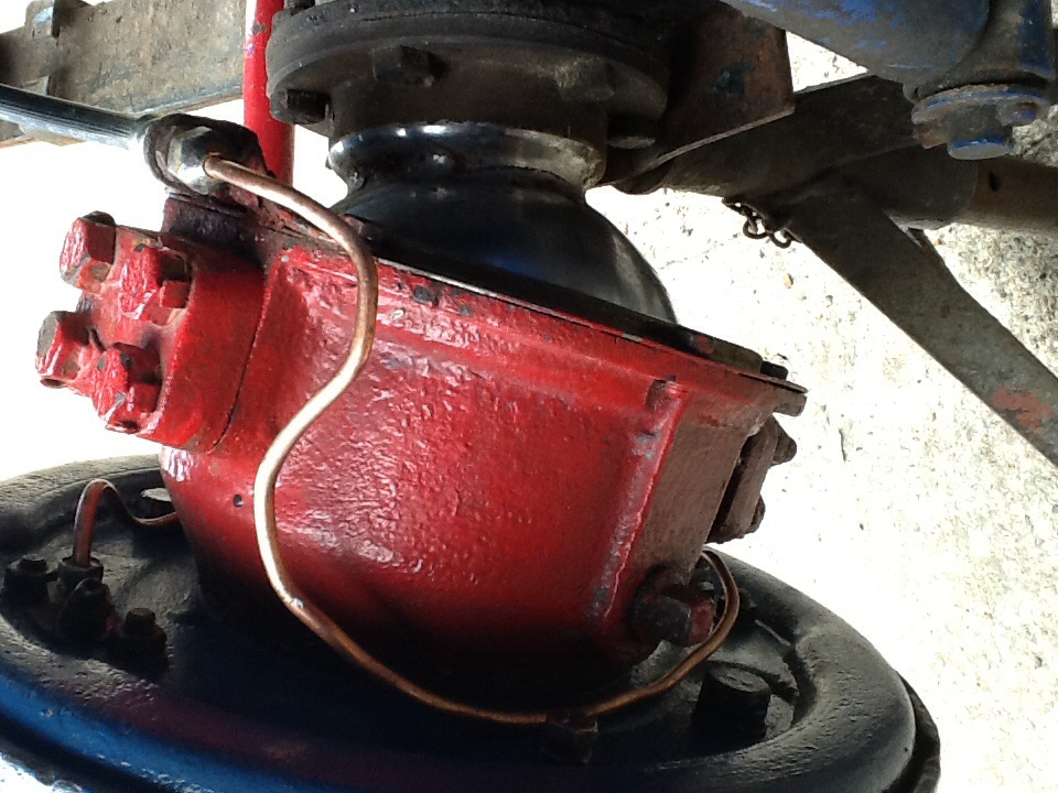

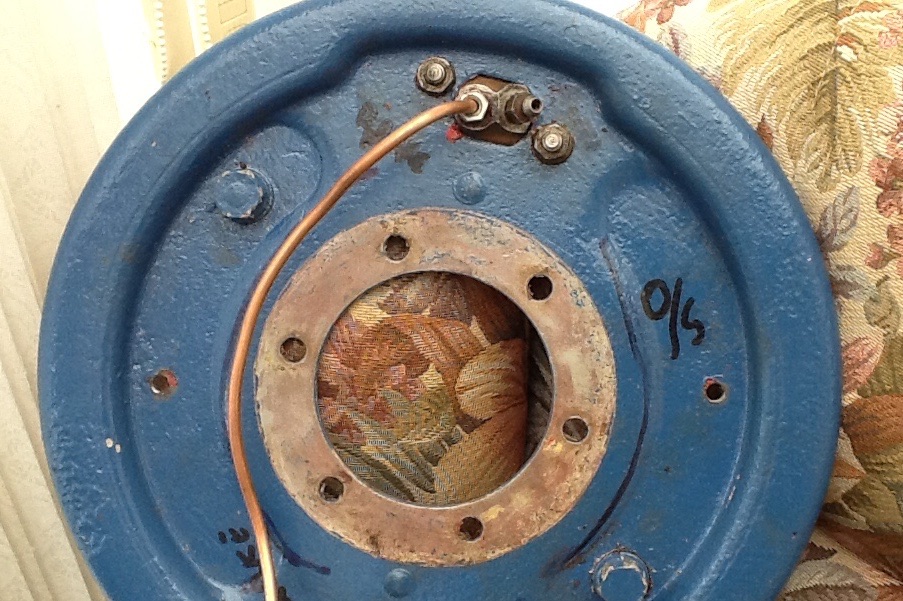

Brads asked me to put these photos on, as he got confused when he was trying to explain when he spoke to you yesterday.
He hopes he's got it right, know doubt people will say if he hasn't.
Sorry if you have to stand on your heads to see the pictures.

Hi Brad & Jayne,
Yes, that looks fine - similar to the way I've done it on all our 109" vehicles
Oh, and I didn't think you were confused Brad - you described it exactly as your pictures now show

It's hard to tell, but am I right in thinking that the bleed screw is at the top of the back plate? Does that help with bleeding?

Yep, that's the idea.
I posted pictures ages ago and Brad was going from memory, I think.
Here are my pictures:
Slightly different layout to Brad's, but the same effect.
Oh, and mine aren't painted

mine has the bleed nipple at the bottom but from what I hear on the other forums if you do it so the bleed nipple is at the top it makes bleeding them a lot easier
Re: Brake system setup 109
Never had a problem bleeding with the nipple a the bottom myself, but I know many have! The pedal on the Carawagon isn't as good as I'd like but the problem seems to be in the rear axle
