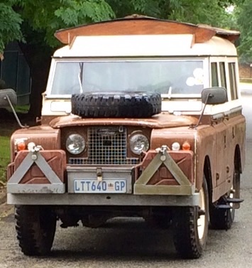

My vehicle is a1968 station wagon, the rectangular cutout in the roof measures 2335mm x 1090mm. Hoping this helps.......
Thank you
Karl

Post by chippit » Sat Jun 20, 2015 7:40 pm
Nice, I will measure my early roof tomorrow.

Sorry I have been a bit busy with work, when I get chance I will drawer round the curved ends to make a paper template with the measurements for the rectangular side pieces drawn on it. I will also measure the bendy aluminium section (this is very damaged on mine but O.K for dimensions), in fact I will do that next so you can check against your roof, hopefully they it will be the same as mine then I can post you the paper template.

Post by chippit » Sun Jul 05, 2015 2:51 pm
Hi Karl,
The older bendy aluminium roof measures 2440 x 1500 I think this should be the same as yours. The later roof that I have from a 1975 landy measures 2440 x 1600. Hope this helps, by the way we are at Rose narrowboats, the heart of the canal system with a good choice of routes. http://www.rose-narrowboats.co.uk
I think the carawagon is a fantastic design, such a simple idea and built by boat builders!
If the measurement of the ali roof is the same PM me your address and I will post a paper template.
Regards Christine
