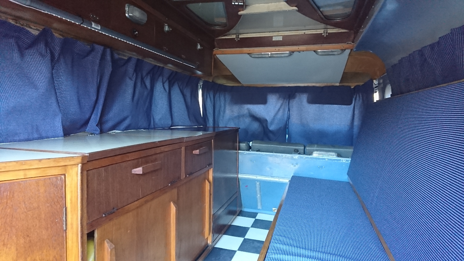

telindnor wrote:We did not have a heater except the prophane stove. So...it is cold on the feet and hot at the head. I would like a heater which can stand on the floor and give dry heat. Suggestion?
