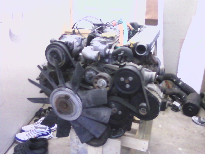

I'm amazed how quick you are putting this together :o Does the disco engine use the original engine mounts ?? I've got a 300 tdi defender unit lined up for my conversion but I'm a bit nervous of starting I thought I'd remove existing mounts and then fit defender items as per the original chassis to overcome the oil filter problem that occurs with this engine.
Can you post some pics when you fit the radiator / intercooler ?? as I'm curious what space is available. I'm hoping to fit the air con unit into mine but I think it's going to be a tight fit.
Maybe if you do get over to oz this year I should try and persuade you to visit our neck of the woods, maybe play engine conversions Here's a pic of my 300 tdi unit
